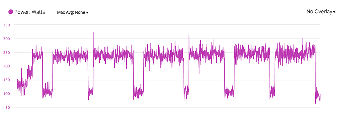

May your legs be smooth, and your power be spikey:
^ that’s the ‘real’ data from the workout. Quarq only.
Wahoo power :joy:
