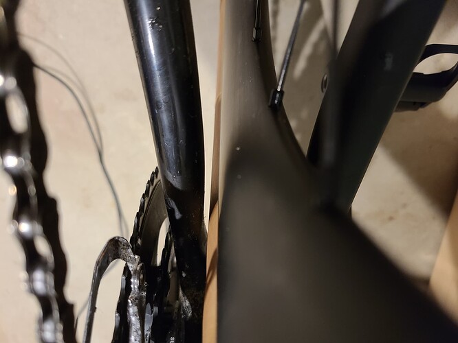

I was inspired by this thread and bought some 700x35 Rene Herse Bon Jon Pass tires for my Roubaix. The frame can handle a 33mm tire, so I though a few extra mm wouldn’t hurt…but the tires are just about 38mm. That leaves 2.5mm on each side at the chainstays. There looks to be plenty of room at the seat stays and fork.
My wheels are 51mm deep Bontragers and 23mm internal. I’ll only be on the road (though surfaces around me can be quite rough).
Am I tempting fate with 2.5mm clearance?
Hard to capture but here are a few. I can just stick a 2.5mm Allen wrench in between the tire and chainstay. I only did the back wheel so far…knew that would be the tricky part if size was a concern.
Be careful. Sometimes rims flex and then you’ll get rub. I’ve seen situations where people have worn down the carbon on their frame in that spot. I’d keep an eye on it.
That’s what I’m afraid of, but I’m also wonder how much these rims could flex. I’d think deep-ish carbon would be pretty solid.

Not just flex, but also debris like small stones may get stuck and scratch your paint. On the other hand, I don’t have that much more clearance (from the top of the tire) on my 3T Strada. Probably you will be fine, just be ok with occasional scratches and keep your bike clean.
My advice would be to respect the 4mm clearance European spec. I’ve had road debris kick up between tire and chainstay, pretty sketchy when that happens.
You’re all right…I’ll keep these for the gravel bike and try something else. Thanks!!!
