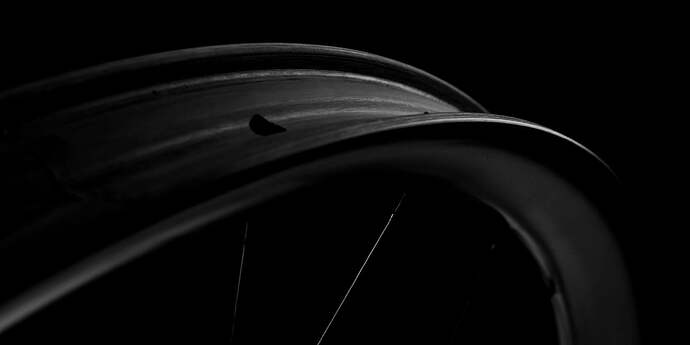

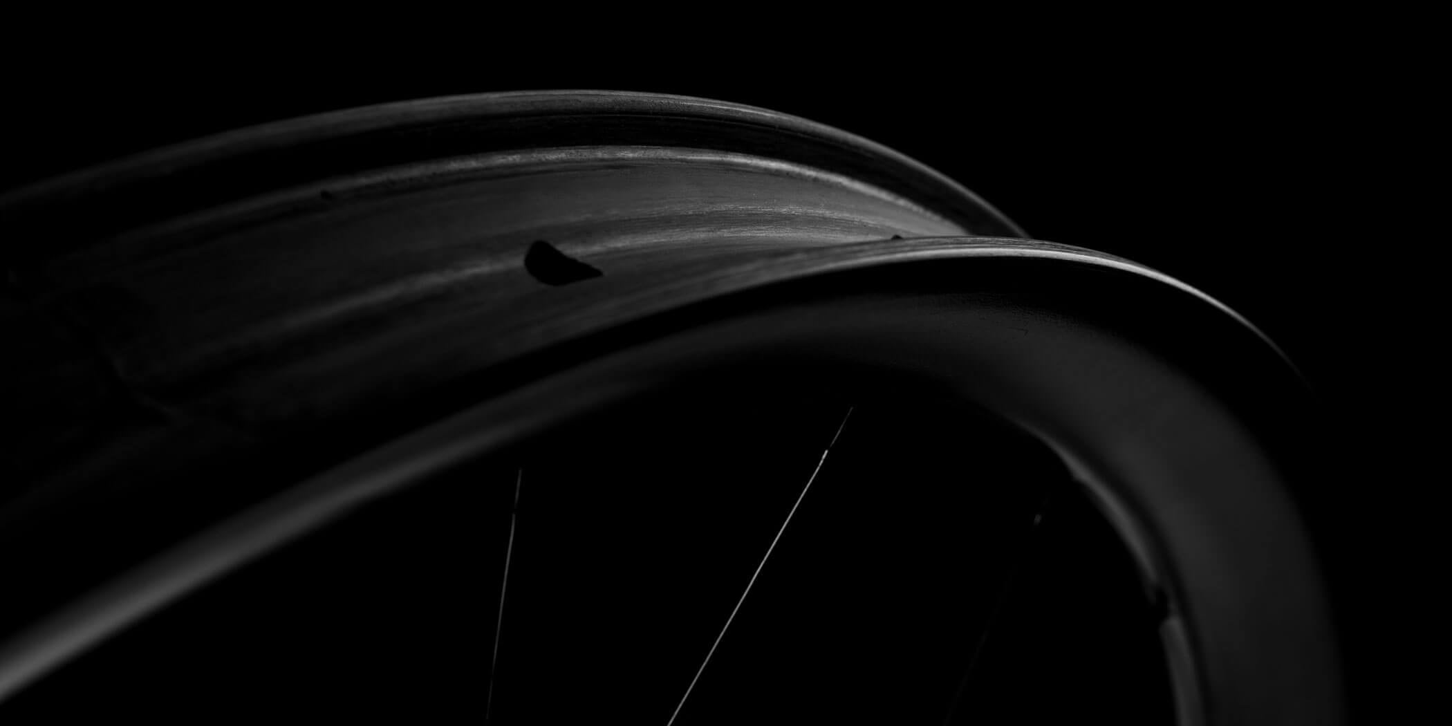

Hmm, I’m not sure thats true. Enve has a good article
and some info in this Roval tubeless done right
https://rovalcomponents.com/pages/road-tubeless-done-right
Worth giving those a read if you are interested in tubeless for road. FWIW my engineer brain is sold on hooked rims for road tubeless, for the additional safety, ability to run higher pressures, and no limitations on tire choices.
I’m currently running 30c S-Works RapidAir tubeless at 80-85psi and these are very comfortable on rough roads, as comfortable as some 32c at 65psi that I’ve run on wider rims.
@BigRed if you want to run higher pressures and not be limited by tire choice, you are going to need to go with hooked rims like these Roval Rapide II that I’m running:
