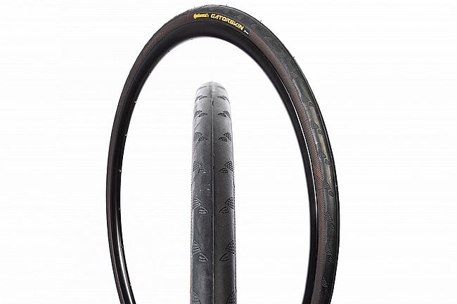

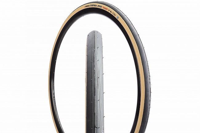

Not sure what your budget would be but check out these links:
More ‘training tires’ (More durable, less speed)
‘Racing Tires’ (Less Durable, More Speed)
