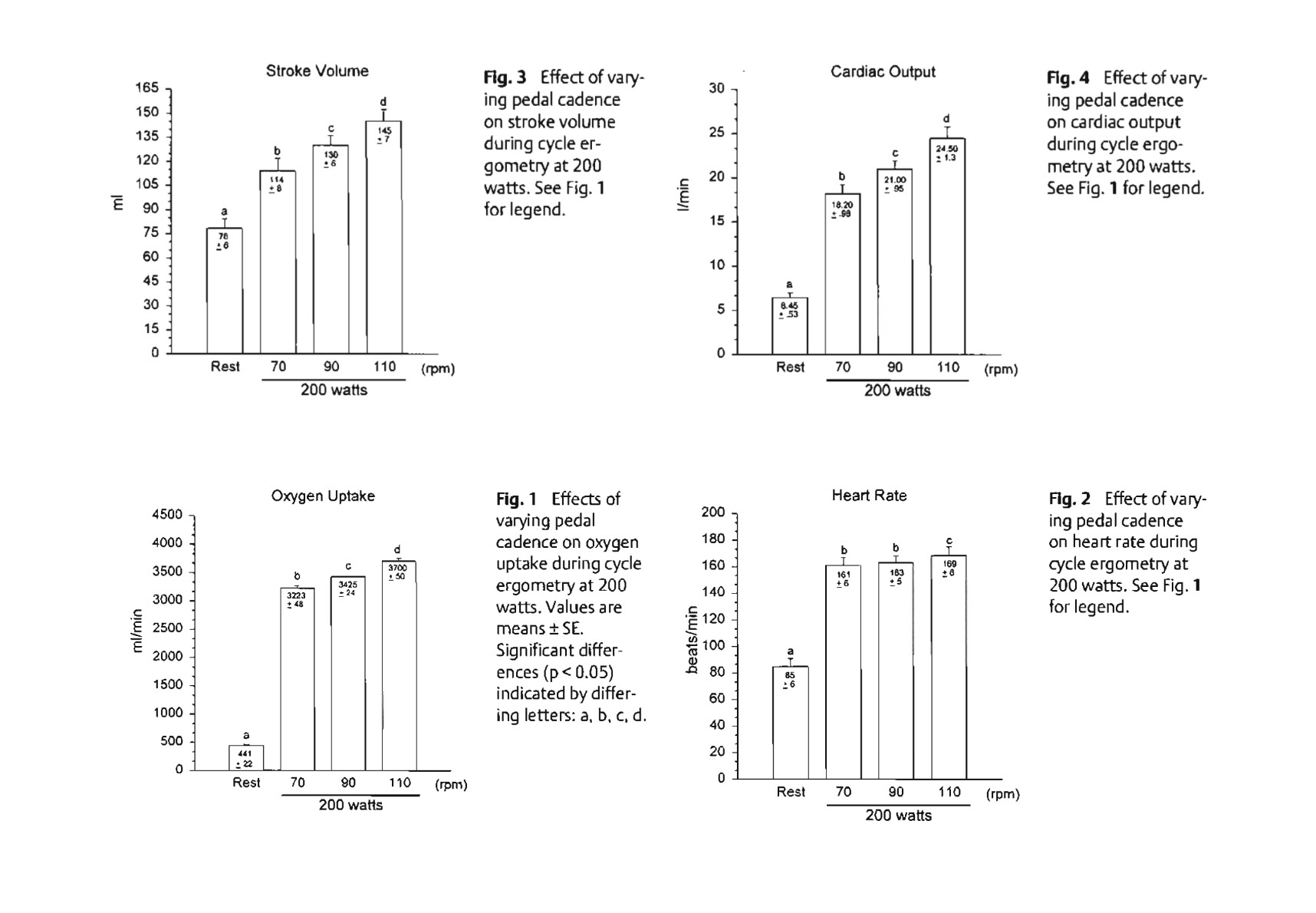

I do wonder if it’s possible to quantify the impact of these factors.
The paper Kollie is citing has these charts:
But I do wonder how these differences translate into Vo2Max gains over time. Does anyone know if this has been studied? E.g., take one group at 70 rpm and another at 110 rpm, keep everything else equal, measure all the standard metrics (VO2 max, etc).
If this hasn’t been studied, it’d be interesting to hear everyone’s thoughts on how to go about speculating/hypothesizing about what the magnitude of the difference might be.

The chart illustrates exactly what Kolie is saying that we need to train (stroke volume and cardiac output) - central adaptions. I’m sure we get some peripheral adaptations too but I’m guessing that we get those with other types of training (FTP, SS, tempo).

I understand the idea. But the question is about quantifying the magnitude of VO2 max impact. In other words, the stroke volume difference appears huge (115 vs 145 → +26%!), so is cardiac output difference.
Would this imply or that one group training at 110 would have 26% more VO2 max gains than the one training at 70? I.e., one group would add 2ml/kg/min and the other one would add 2.52ml/kg/min? Or would the real-world difference be more trivial? And how much more trivial? 13% instead of 26%? Or 1.3% or any other number?

Can you post a link to that study?

All I’m saying is that it would be helpful to see a study that actually quantified the impact on metrics we actually care about, such as VO2 Max, power, time to exhaustion, etc and showed the mean, median, and SDs. Before we can see that we can’t know for sure that there would be impact on these metrics and whether it would be major or minor.
The study is linked in the podcast episode notes, here it is:
