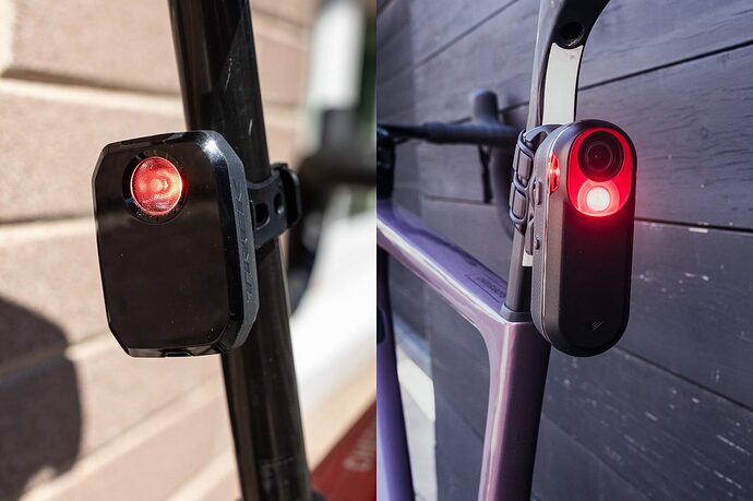

Maybe something has changed for the better in the 3 or so years since I had a Varia, but I always found the various Flare rear lights to have notably better visibility in daylight. If that same light is used in this unit, it’d make it a compelling product for me… and perhaps give me a reason to give rear-facing radar another chance.
As a long time Flare user, the latest Varia RTL510/515 are rather good. Perhaps still a bit under the Flare level, but far better than the original Varia model.
As mentioned, I do like the variable light function of my RTL and am curious if the CarBack has something similar. I find the “smart” pattern handy for other riders as an indicator they can even leverage to a degree in pack riding, but the variability seems a worthwhile feature aimed at catching driver’s attention. That said, the semi-irregular pattern in the Flare and presumably CarBack are very good for attention even without any “smarts”.

Yeah the battery life on my Varia is ordinary, and my Bontrager lights are brighter - so if this new radar is bright, with better battery life than my Varia I’m in. Also, I damaged the USB port on my Varia and I only have one (from a gazillion) USB cable that seems to work with it now. If I lose that cable I’m in strife. Just saw this comparo, interesting that the Carback seems to have fewer dropouts, I do notice that my Varia loses connection with the Edge annoyingly often.

Unsure about degradation but life is covered in Flow’s review Fresh Produce | Trek CarBack Radar Light - Flow Mountain Bike
“On the box, Trek claims the battery life to be 7 hours regardless of the brightness or flashing setting. We asked Trek AU about the run time, and it said radar is the most significant battery drain, and the team tested the CarBack at worst case, always-a-car-in-range, radar use. Trek predicts up to 10-12 hours on a single charge in more realistic conditions. The Garmin will go for up to 16 hours on Day Flash mode.”
