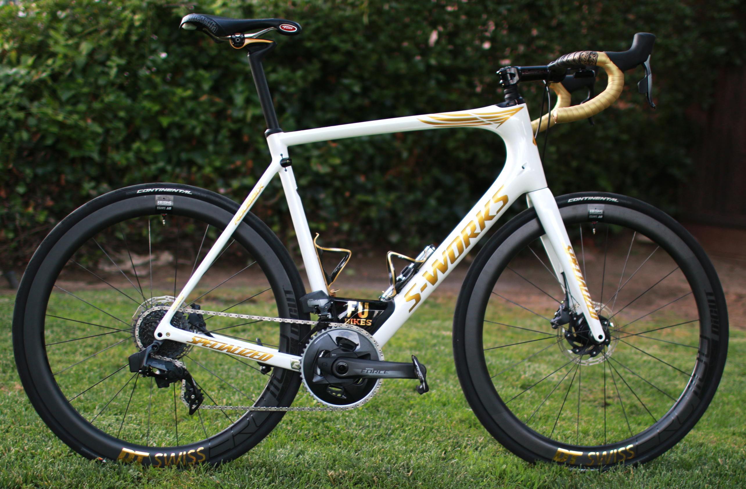

@Alexbn921 I’m really digging the matchy gold elements. So good!
