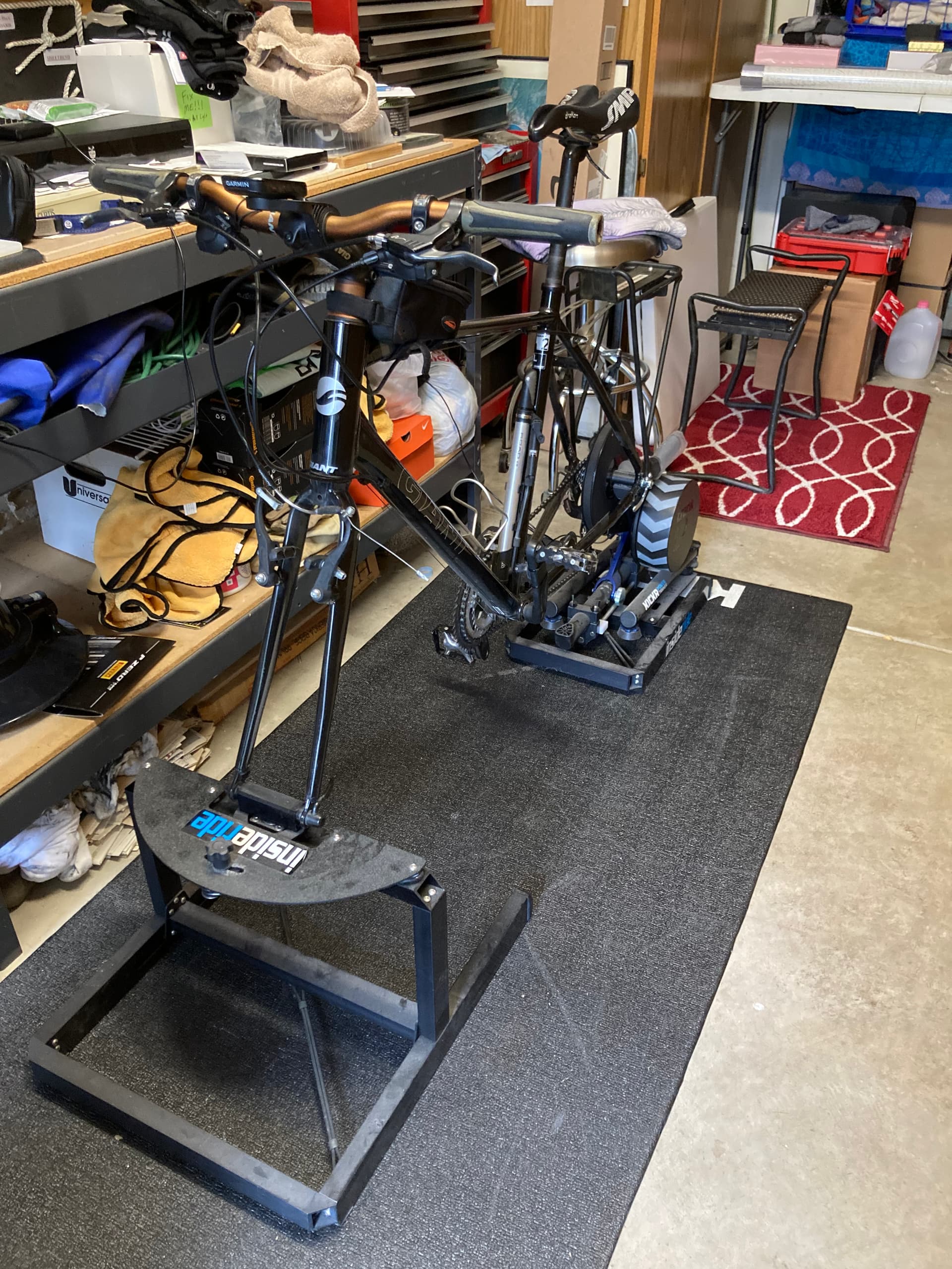

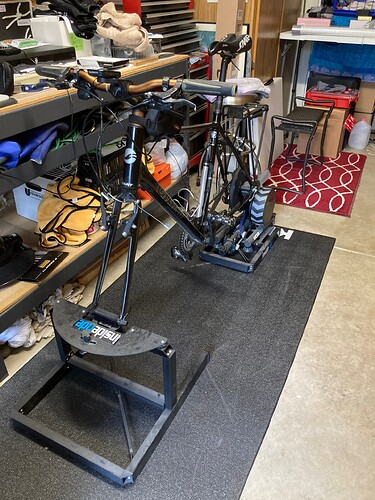

how long have you been using the InsideRide? thoughts?? i’m on the edge of buying one, have been staring at it for a month or so…
Do it. The motion makes a huge difference for long rides (or even short) on the trainer.

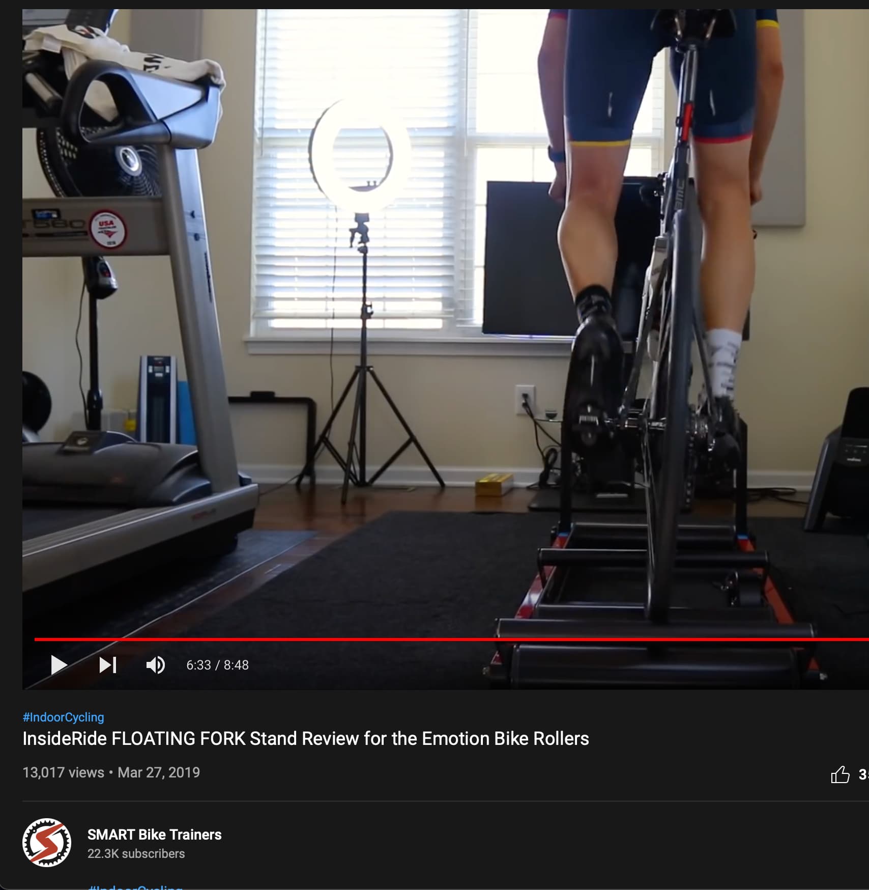

I have a few links to reviews, including my lengthy review.
Brian also has several comments in the same thread as his review. This and several more following it.
^ 2nd link is my review (under previous username).
Over the weekend I ran across this review:
and if doing over I’d go for the e-motion rollers with floating fork. Because I think that provides even more realistic side-to-side seat motion. Haven’t been on the trainer in 8 months, will let you know if tonight’s ride changes that thought process.
Did an hour last night and happy I bought the InsideRide for my Kickr. That and using RGT in sim mode to virtually ride a course (Leuven Belgium). Next time I’ll take Zwift for a spin.
Interestingly Kickr/InsideRide with Erg/TR and my butt starts hurting after 45 minutes even when periodically standing every 5 minutes.
Sim mode is soooo much better than Erg. Even without the freely moving back wheel of rollers, using sim mode again makes me want to keep the current setup.
