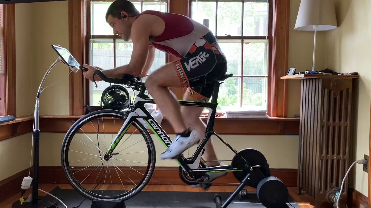

Any thoughts on this fit? I think I could get a bit lower in the front, but am weary that I might have issues holding the position for long periods of time (racing halfs primarily). Generally comfortable now, but open to suggestions from the crew.
Looks fine to me. You could always experiment by dropping the stem one 5mm spacer and try some workouts inside, and rides outside.
