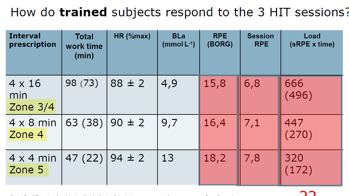

After crunching the data the researchers provided average power relative to their FTP / 40-min TT. That is what you see in the chart above. What’s interesting (to me) is that self selected max efforts look very similar to Coggan training zones.
And so the RPE based intervals resulted in the following averages:
  • 4x16-min work done at average of 95% ftp (TR threshold, e.g. similar to Mount Goode +5)
  • 4x8-min work was done at average of 106% ftp (TR VO2max/threshold, e.g. Jacks +1 or Raymond +6)
  • 4x4-min work intervals were done at average of 117% ftp (TR vo2max/threshold, e.g. Vendever -1)
