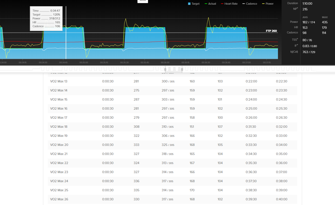

For this morning’s ride my target power was 312 watts (120% of 260 FTP), but when looking at the analysis page all the intervals are listed as target 305 watts whereas the blue graph correctly shows the 312 watt target. Any ideas what’s going on here?
