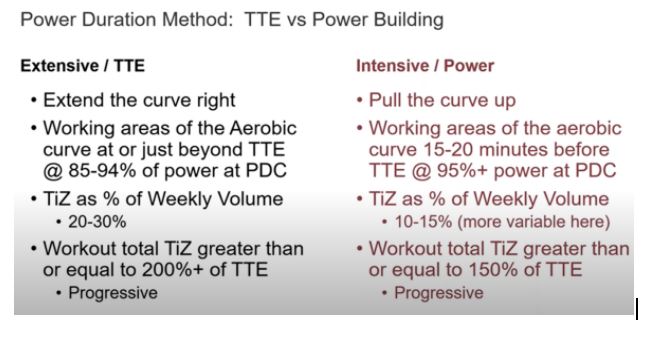

My TTE is 55min. So for me is that 35-40min. 95% of my 35-40min power is +/-255w. (Do you use MMP or PD curve)?
But when i look at my Optimized Intervals in WKO5 the give for (FRC/FTP) intensive aerobic (FTP) intervals with 27min between 272w and 252w.
So i dont understand the idea of Tim in that webinar. Can you explain this?
i had the EXACT same question last night myself.
I know that you use the PDC for calculating the 95% power target. But for the optimized interval, not sure how to work that in.
Using your example, would a good workout be doing 255w for 35min, 2-3 times to get to the TiZ target that’s likely 60-90min?
Or is that something you should be building up to, ie. doing maybe 5x10 and 4x15min @ 255 to try and hit your TTE target for TiZ, slowly extending those intervals out over the progressive block?
Iam in the WKO5 Facebook group so i can ask Tim a question, but i think that i can better focus on consistency than to much energy spending on details.
My Optimized interval for Intensive Aerobic is 28min 272-252w. Thats nearby 35min with 255w like your calculation. Intensive aerobic is 55min (TTE) 267-247w. I will focus on my Optimized intervals and going not more in detail with calculations like 15-20min onder TTE with 95% of that time etc. Better a lot of good work than a couple of excellent workouts :wink:

WRT the interval construction Tim cited in the webinar, I took that as targeting for steady state intervals, either specifically at FTP or in the neighborhood (SST). I don’t think they’d have exact applicability to this kind of threshold work where some substantial portion of it (in my case 12 min out of 57) are done significantly above threshold. I think the general guidance would be to aim for a total working time of somewhat less than TTE to start, and then building out perhaps to TTE by the end of a block, while getting long enough bursts to generate lactate buildup, and recoveries long enough to be ready to go again without being bored.
That’s why I spent some time playing with and thinking about the ratio of O/U when working in that low VO2max zone rather than high threshold like TRs O/Us (e.g. 110-112% vs. 105%). Essentially what I landed on last night was the equivalent of Carpathian Peak +3 for this specific style of interval, and that was kinda what I was aiming for - long over/under intervals sustained for near TTE duration.
TL;DR: Keeping in mind that these are intensive intervals, I have been more focused on increasing power, both the under at high SST and the combination of power above and time above threshold, rather than strictly extending workout time. So as I progressed these, I was looking for more total time spent ā€œoverā€ and a slightly higher ā€œrecoveryā€ power, first; adding total TiZ second.

I’ve been reading your past posts and I also watched Tim Cusick’s lecture and I have some questions.
I did a 60-minute FTP test on Monday and got 253W average, rounded FTP to 255.
If I understand Kolie Moore correctly, the best way to train my FTP is to ride at FTP or just below it.
So I’d start by doing 6x10 - 5x12 - 4x15 - 3x20 … (example he gives).
If I understand Tim Cusick correctly, I should aim for 200% of TTE, ergo 120 minutes at FTP. I should ride at FTP or just below it.
So … to train my FTP, I have to do progressive overload by doing longer and longer intervals at 230-255W (90% - 100% my FTP)? Do I understand this correctly? And then re-test when I’m able to hold 255W for 1x120 minutes?
How do I approach O/U intervals? I’d do 1 O/U interval each week to break the monotony; should I go let’s say 4x15 (2 min under/1 min over)?

Cusick as I understand him:
Work at sweet spot for 20-30 per cent of weekly volume. Starting with 2-3 intervals and progressing to 1, increase TiZ in each workout to at least 2 x TTE.
Use SS workouts; or high tempo with cadence drills [70 – 80 – 90+].
Sorry [misplaced ]
Then, when hit target, progress to:
Find power at 15 minutes before TTE. Set this as power reference point [PRP].
Work intervals at 95 – 105 per cent of PRP for weekly TiZ of 10 – 15 per cent of weekly volume.
With 2-3 intervals, progress to 150 per cent of TTE in each workout.
In this case for TTE; Does this mean TTE on our FTP? Or the TTE on SS (like 90% pwr @ FTP).
If my TTE at FTP is 40 minutes do I use that as the base for sweet spot? So I would progress sweet spot intervals to 80 minutes per workout?

My TTE is 55. My MMP is 266w and PDcurve 276w. Do i use 266 or 276w?
On the sheets i reed PDC (PDcurve).
So for me is that between 262w and 290w. For 80min TiZ per workout. Starting with +/- 3 intervals and progress to 1?

It’s just a bit hard for me to understand how this works:
I’m already able to hold 255W for 60 mins. How is working 6x10 at 90-100% FTP, or then 6x12, 5x15, etc. going to improve my capablities?
