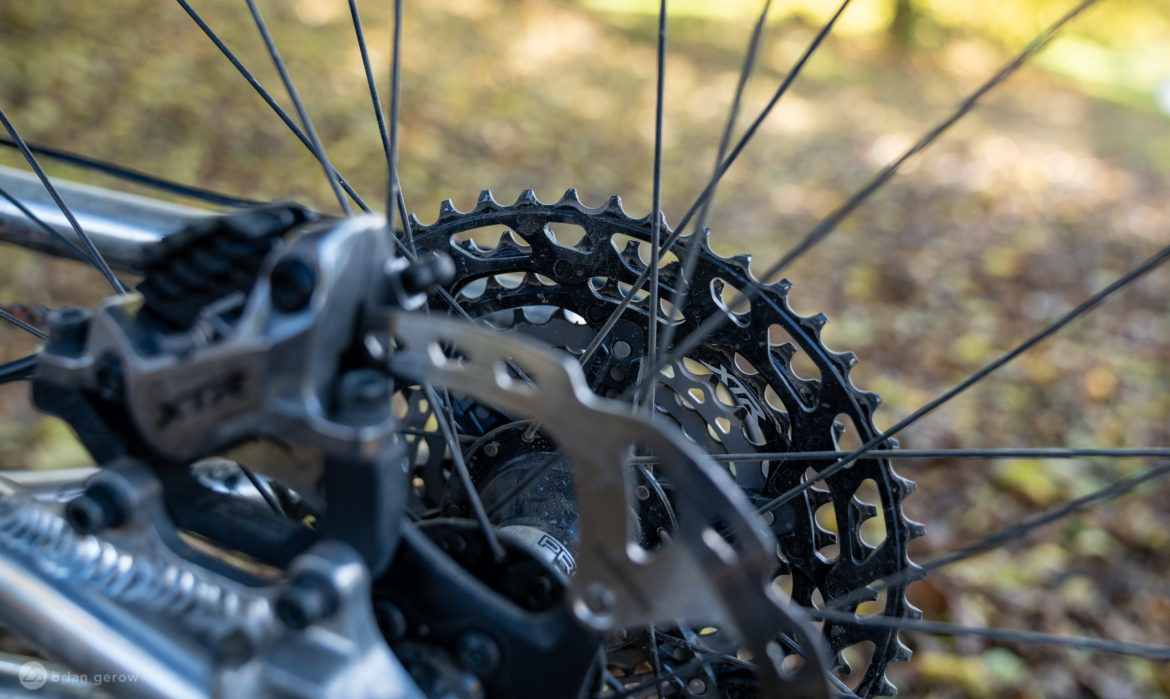

I just put a Rotor 12 11-39 on my AXS bike. It got me thinking… a key driver for smoothness is the spread of the cassette. If you’re going from a 16t cog to a 15t cog, you’re putting a 1-link GONK into the chain when you grab a taller gear. If you’re 25t to 22t, you’re putting a 3-link shock into the system. I think Shimano’s new HG+ works to solve this by letting the chain move down earlier in the rotation, giving it more room to work and grabbing moving the jump to the area between the cassette and RD.
On the rotor cassette with AXS…it’s expensive, super super light, offers way better gear ratios than SRAM / Shimano offerings right now, but it’s a bit jumpy moving to lower (outward cogs) vs SRAM. You trade the useless 10t cog for a very useable 14t cog, and they space out the bigger cogs more. It moves inward and runs super smoothly. I tried both a flattop and eagle chain. On the bench with a few spare links to test, it seemed like it was made with the flattop in mind. Both worked, but the flat top chain seemed to work 5% better. THIS IS NOT YOUR SMOOTHNESS ANSWER
@TooManyDogs With my rethink… I’d point you to a Shimano 10-45 or whatever GRX 12 will be once they’ve got a road shifter that will work with a gravel cassette with HG+ next year. On your gravel bike, give a Eagle 12sp chain ($30 or $80 for the long lasting one) a try as it gives the chain a bit more room to snake on a shift (and your wolftooth ring should be OK with it). I don’t think using a GRX/SLX/XT 11-42 11sp cassette ($56 new) a try, but that’s not the answer.
