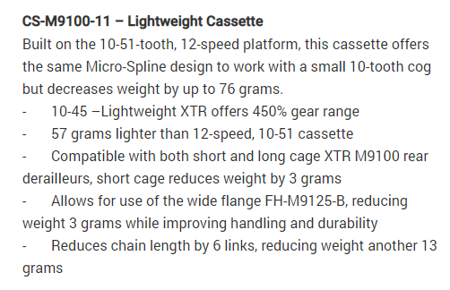

I didn’t realize shimano never released the one they talked about
Yeah I’m strongly considering Shimano for my next bike because of the 10-45. I just don’t need a 10-50 living in Michigan.
I’m almost certain they did. A quick google shows it for sale and in stock on a couple websites.
That’s good to hear. I was just going off what Steve said above. Maybe I’ll look into that system
