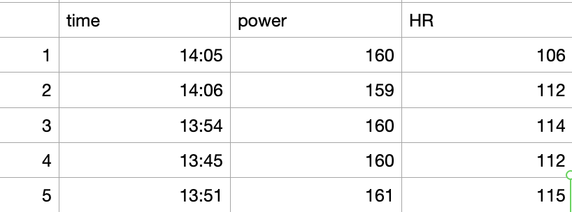

Thread revival! So in the time between then and now I’ve done a lot of laps and gotten some decent data. For example, here are some runs in baggies vs. skinsuit
clothes

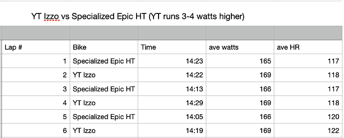

I sold the Spectral…just a bit too much bike…and now have a 2022 YT Izzo and the 2018 Specialized Epic Hardtail. I’ve been racing the YT in our local(ish) endurance series and have been having a really good time. Thing is…the hardtail still feels way faster. I mean, subjectively, it isn’t even close. The hardtail just leaps forward with a gentle push. The Izzo feels good…but not super blazingly fast. So…I’m revisiting the HT/full sussy issue.
First, I’d like to run the powermeters that are on the bike (no F1 pit crew available to swap cranks). The YT has a quarg powermeter and the Epic has a power2max. Yesterday I did a few runs in the garage on the Hammer H1 trainer set at 180 watts. I calibrated between runs and got two on the YT, three on the Epic. The YT with the quarg read 188 both times, the P2M on the epic read 178, 176, and 179.
My take on this is that if I rode the YT/quarg and the average power said 188 on my garmin, I’d actually be putting 180 watts to the rear wheel. And if I rode the P2m on the epic and the garmin says 178 then I’d be putting the same 180 watts to the rear wheel. That’s my plan for tomorrow. I’ll do a few runs and keep my average power at 188 and 178 and see what the H1 reads. If I get consistent readings of 180 then I’ll be all set for some laps on Sunday.
Does this sound reasonable? Does this sound like a decent way to standardize the power?
OK, also, I’m going to run 800mm bars on both bikes and try for the same body position (put a higher rise stem and wider bars on the HT vs. stock). And I am going to run the same model of tire up front and in the rear. 2.6" kenda booster pro front and rene herse fleecer ridge tires in back (these are what I have available). Both chains were in the chain spa today and are freshly waxed. No clothing changes during the runs and alternate bikes every run.
That’s the plan! It’ll be Sunday for the laps so I might have traffic issues but I’ll try to get some data.
Joe
With the freshly waxed chain I can believe a little more efficiency from them…and Quarg was consistent. As was the garmin pedals…although not very close to the actual power (has elliptical ring on it so that might be part of it). Power2max read 10 watts low to 2 watts high so not consistent enough today.
If I would have just stopped after 6 laps I’d be happy with my data. Grrrrrrr!
Joe
This was in the garage topping out at 91 humid degrees and I used the volcano circuit on zwift for the laps. Drank 3 X 16 oz and still lost nearly 4 pounds. I mention this only because heart rate data might be our best bet for testing these bikes. I got my third bottle and filled it with ice and water between laps 6 and 7 so maybe that is a confounder too. Sure tasted good though!
Joe
*Quarq
Interested to see your findings, last time the data was far from conclusive. It’s a tricky thing to measure, so I’m interested to see how you get on.
