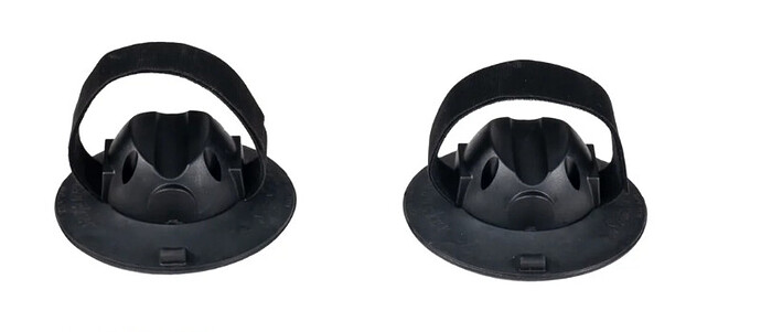

Has anyone tried… using the rear wheel holder to carry skis on the roof of a car? I have two of the rear wheel mounts and only 1 pair of skis. I wonder what would happen if I were to velcro the skis onto these mounts. Think they would fall off? Of course, only one way to find out, but I thought I’d ask here in case I’m being stupid and I haven’t really tested the limits of the velcro
I’ve done that on the older, flat versions of the wheel holders. It works without a problem if you put one in front of the bindings and another one behind the bindings.

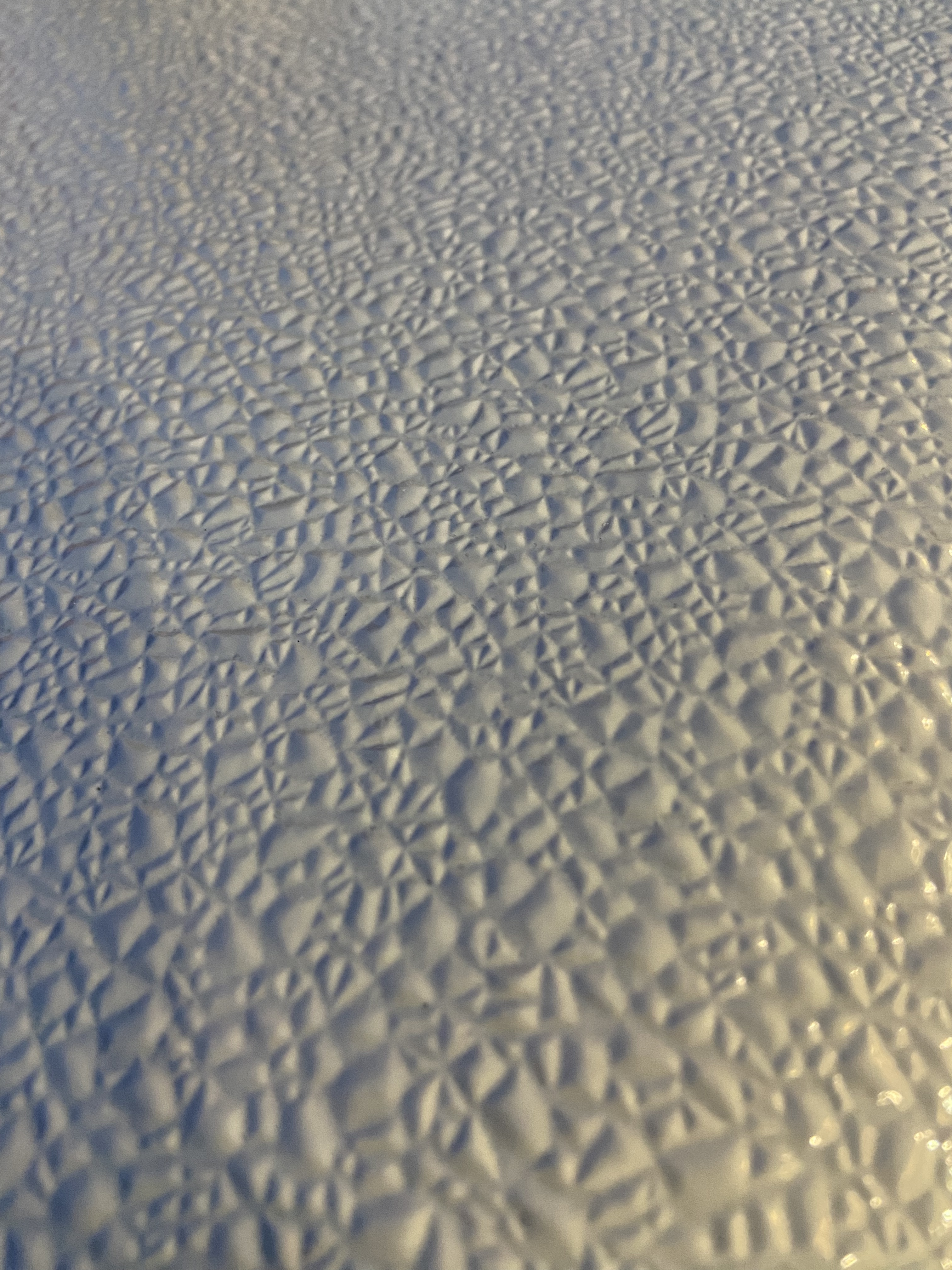

Well guess what, the roof looks like this;
After talking with SeaSucker, it was painfully obvious they did not have anything to offer for me. I read through this thread and thought, well lets maybe make one. I ultimately went with a Woods Power-Grip product.
I have to tell you, these hand vacuums ARE SO NICE!

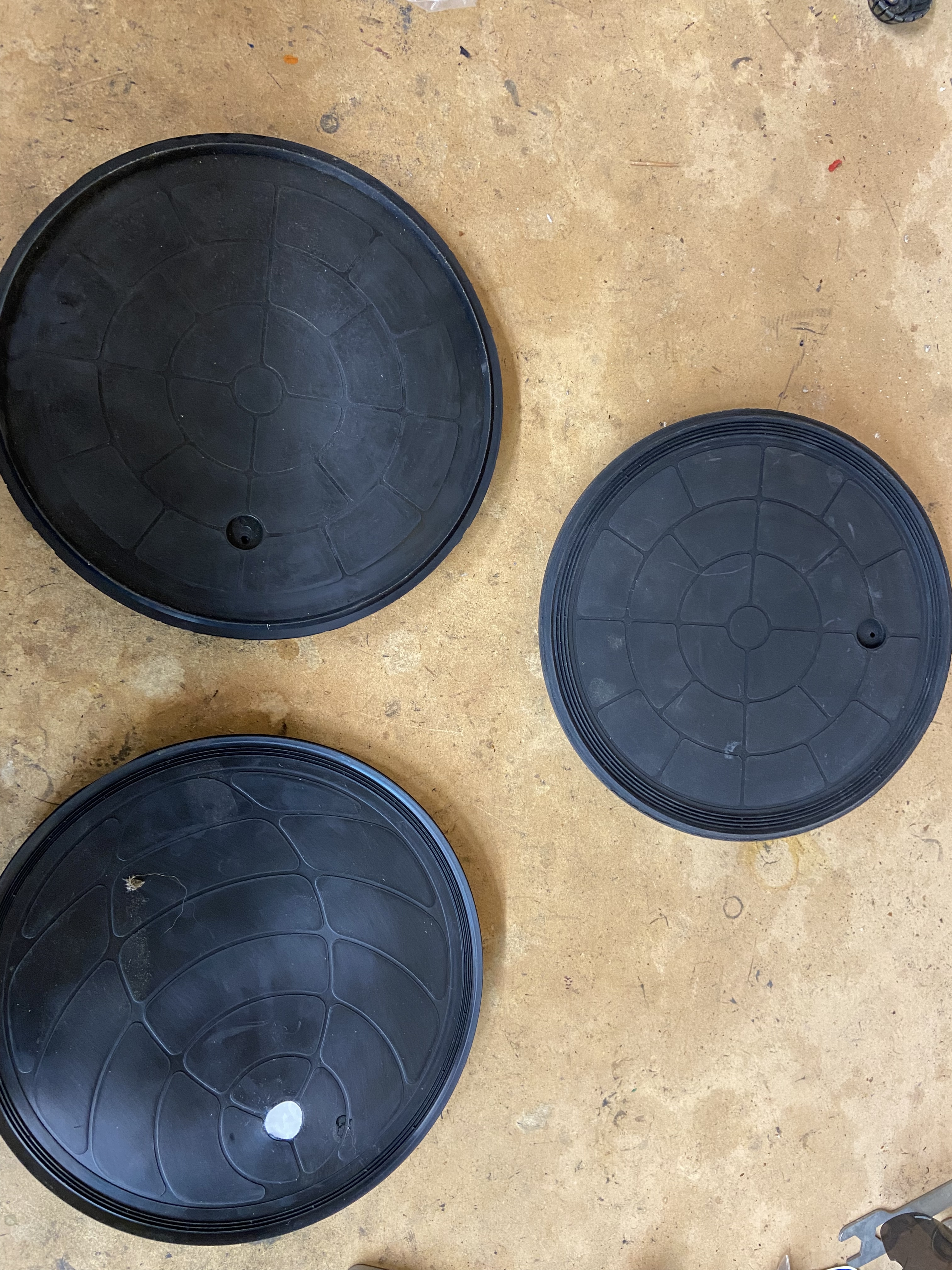

I worked with resident and amazing engineer @mcneese.chad and we determined to test a 8" cup and I tested (3) different pads on this textured surface. I would ultimately end up with a N4950TS
When the right pad was realized - it blew my mind at how well it gripped/held onto the roof. In my testing the hand vacuum held for over 24-hours without letting any air escape. This was an amazing feat for me!

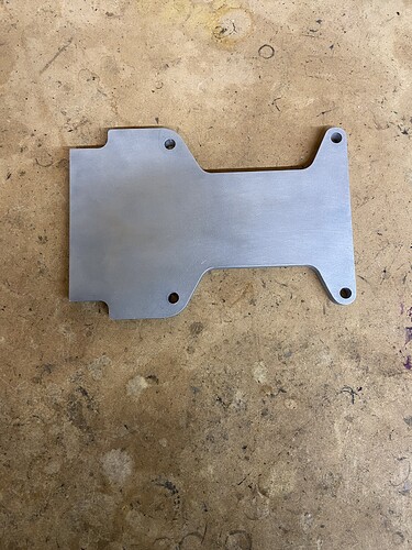

The next phase/part was to machine an actual plate/mount again for the sucker cup. Once again, an amazing @mcneese.chad gave some awesome input on this!

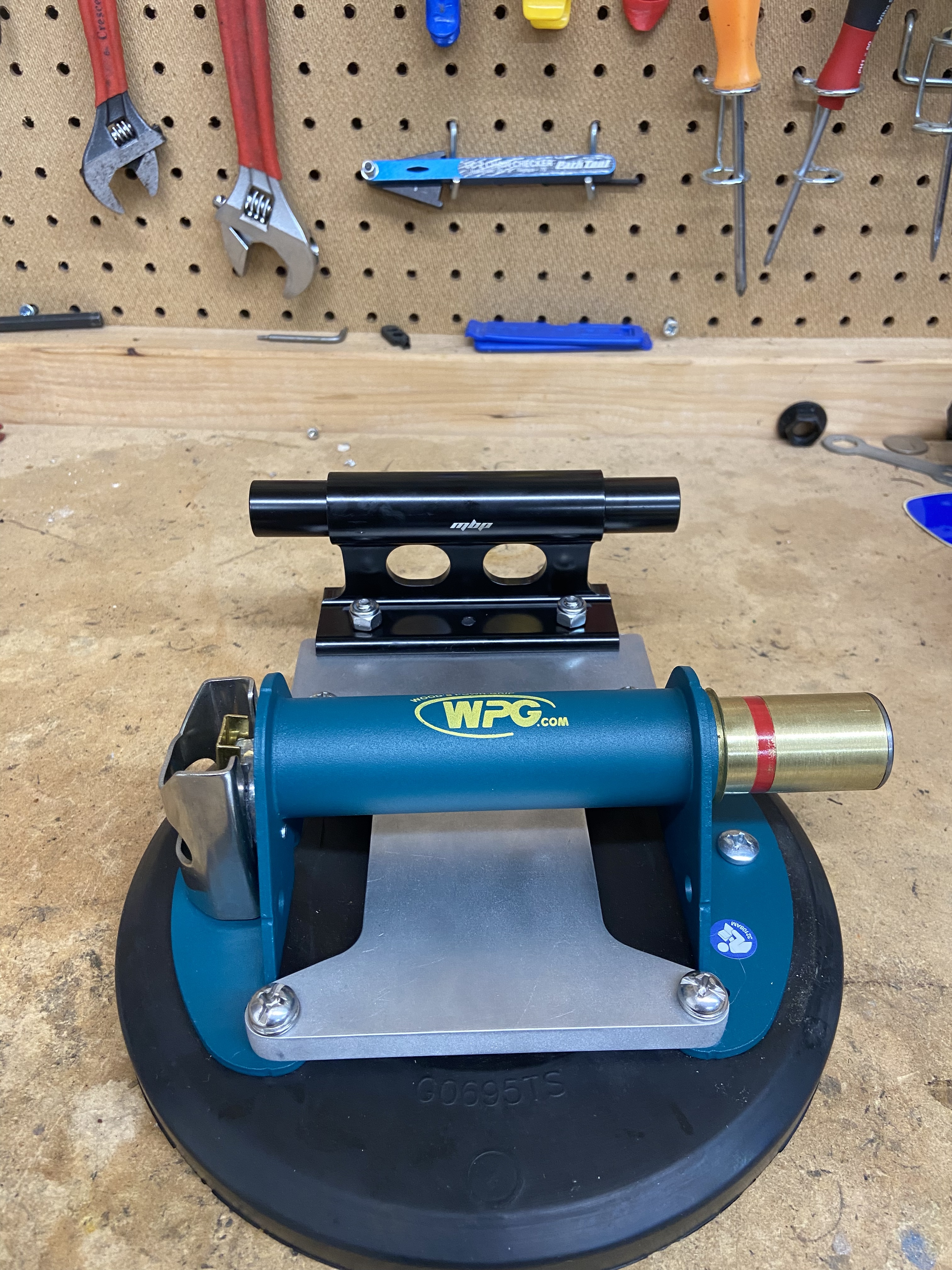

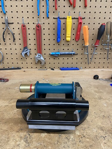

This resulted in a prototype plate that looks as so
Awesome!

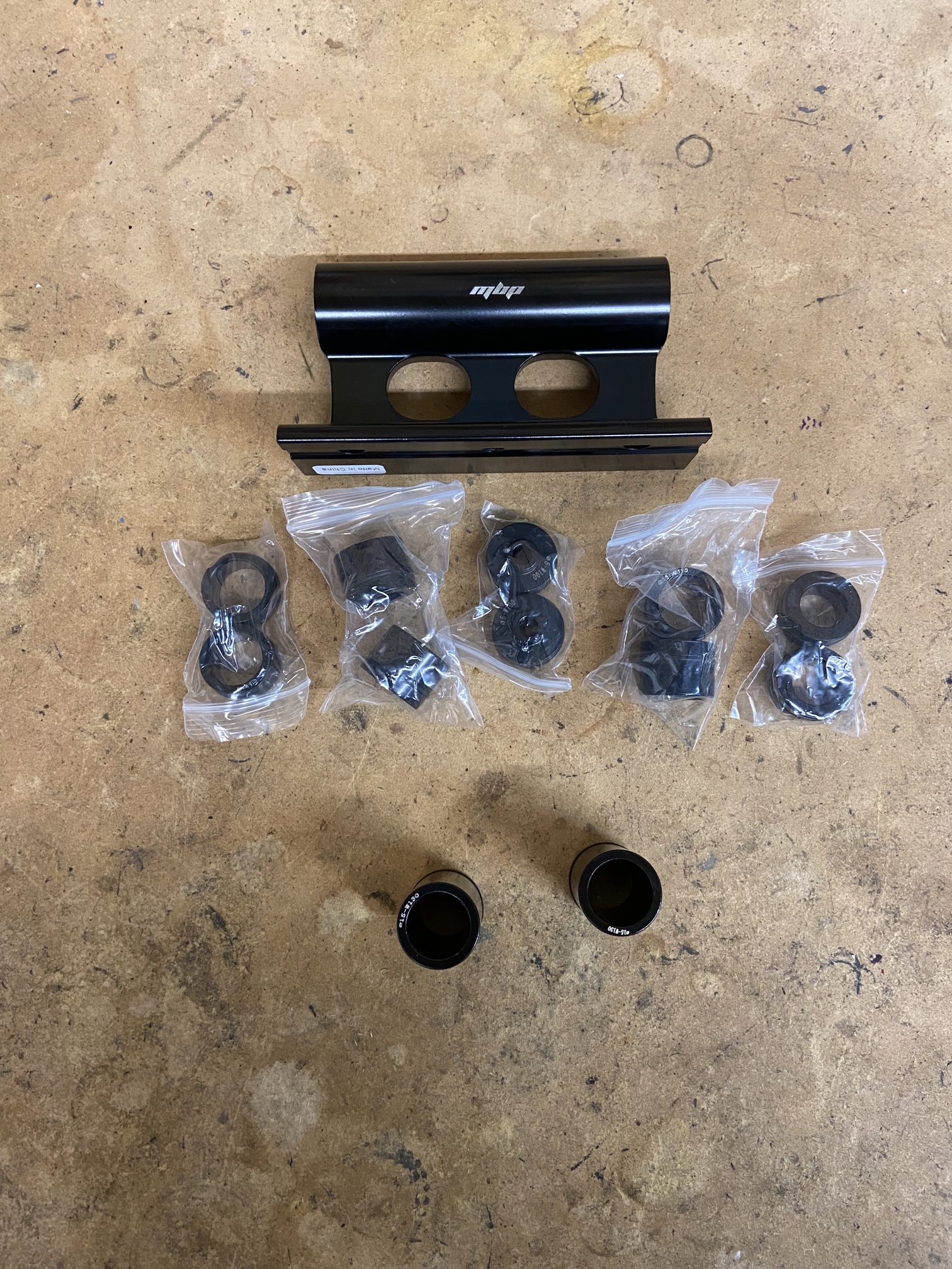

The next step was to figure out how to mount the flurry of bikes I had in my stable, so I decided to go with a multi adapting fork block from Amazon. This unit allowed me to fit everything from my fat-bike all the way to a old QR road bike I had. I will forewarn however, the inserts will not stay in the block while traveling if you do not have a bike on, so be sure to pull them.

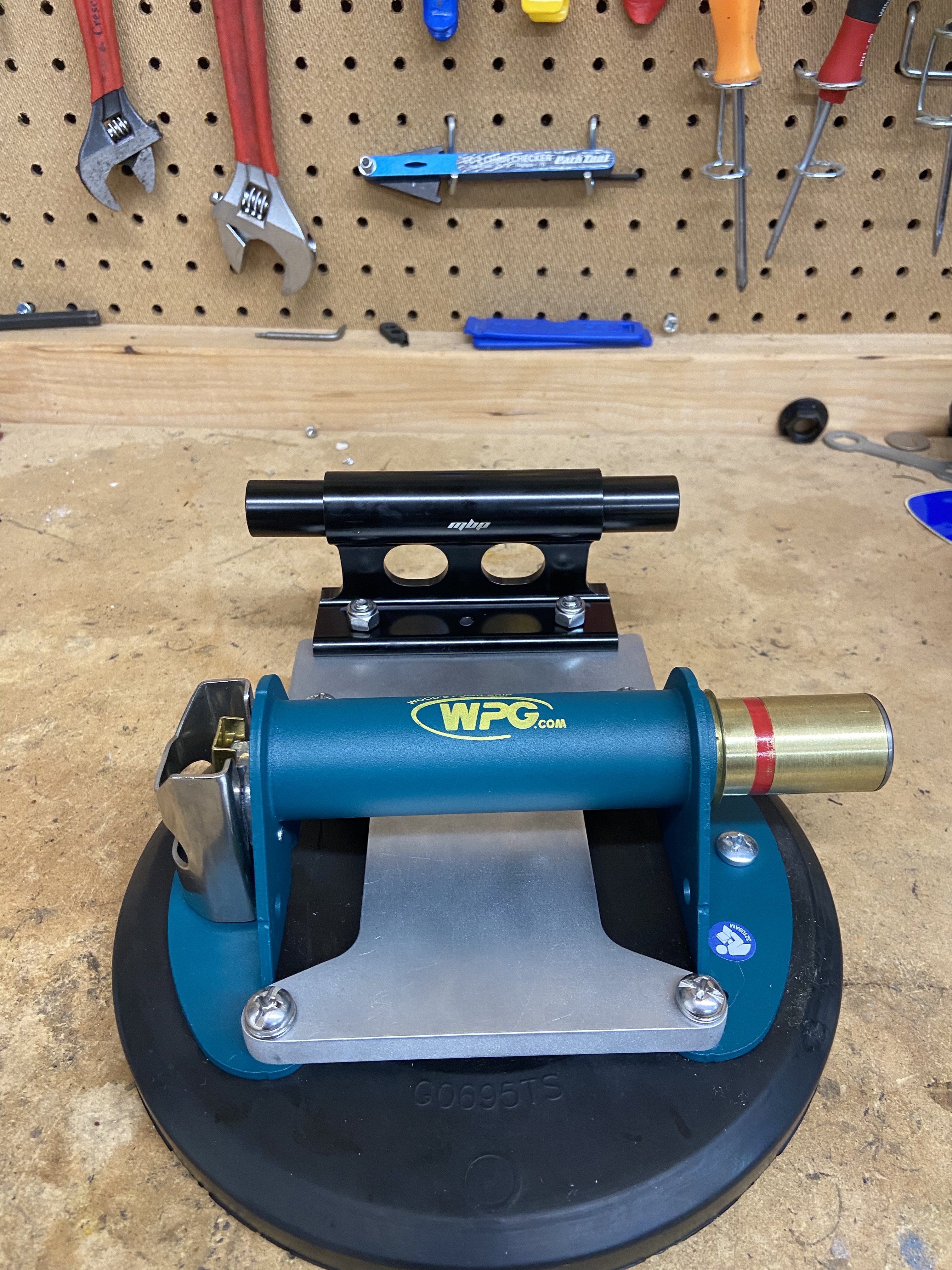

Now that everything was engineered and machined, it was time for assembly

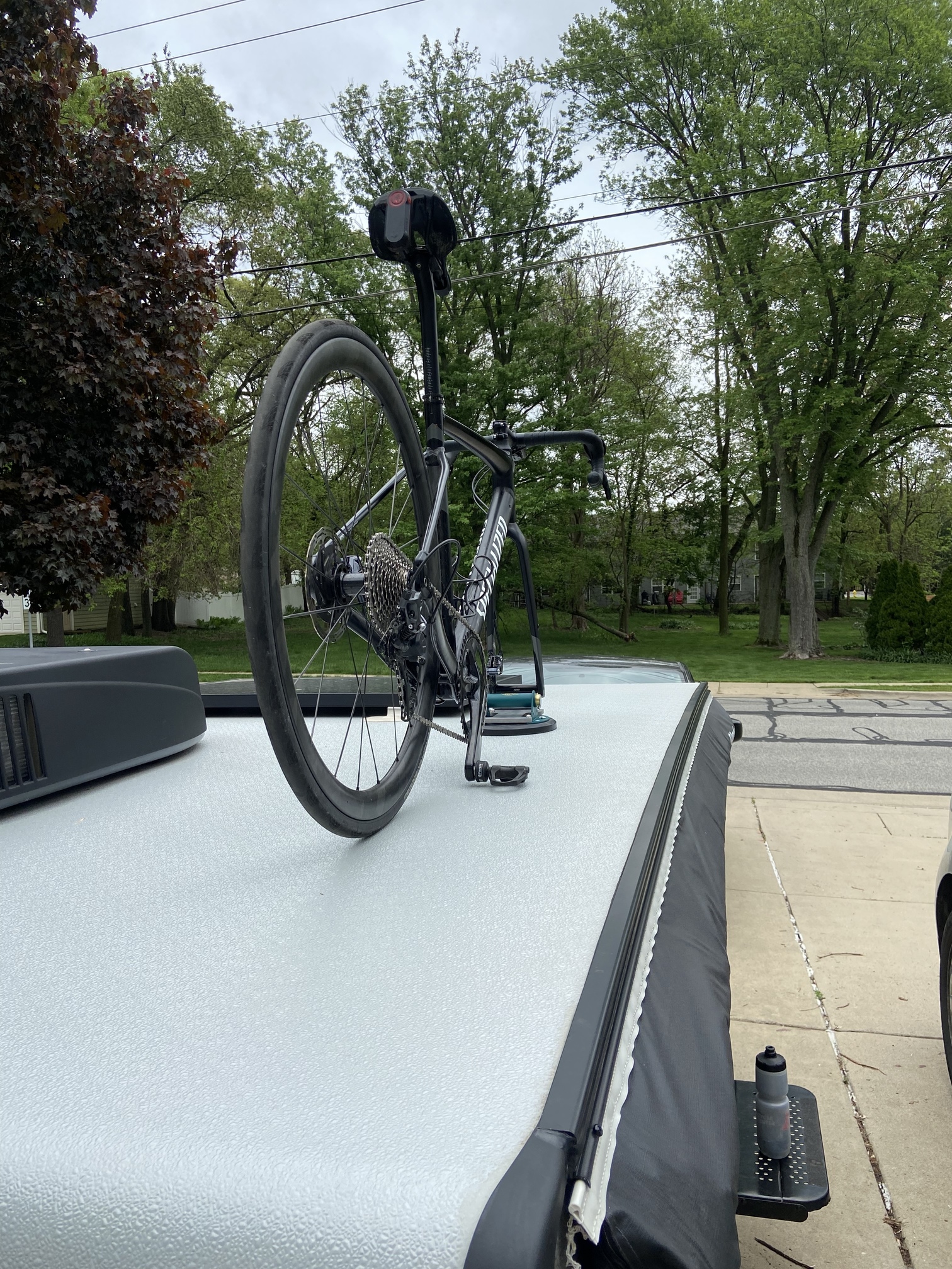

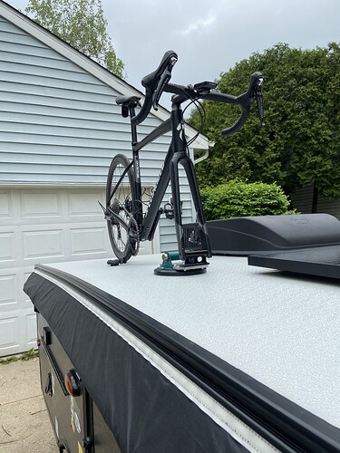

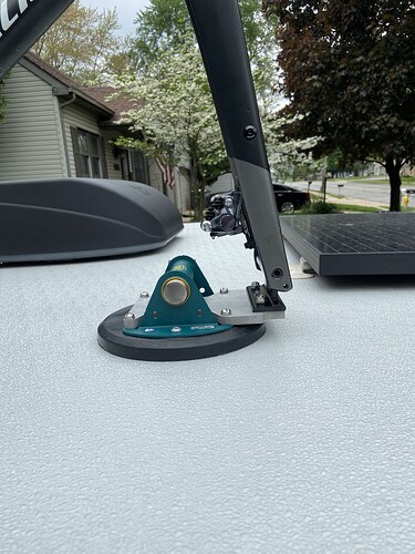

Then it was the final test on the roof itself.
I am so glad that I went this route! I am going to make a rear wheel one now (maybe I will see how much it bounces around first :man_shrugging:t3:
I intend to make 2-3 more of these for my camper so I can take all of the family bikes with us. The best part is, I can pop one off and put it on top of the van if we need to travel to a destination ride.

Those Woods cups are pretty powerful. But… As someone who has used them for their original purpose daily I’d want some redundancy. It’s why Seasuckers have at least two cups.
I’ve dropped a couple pieces of glass because the vacuum failed for whatever reason. It’s very rare, especially if you start with a good seal, but the risk of losing a bike is high if it does. Most failures I’ve had were because of the glass not the vacuum. With a surface that doesn’t shatter this is less likely however.
I’d for sure have still have one for the rear though. If that front one ever released for any reason your bike is gonzo.
Much appreciated feedback!
I intend to get a rear one built when I can. I was actually on my way to post on this thread that it took 52-hours before the current suction cup released enough pressure to show a low pressure warning. That is super impressive and re-assuring to myself.
