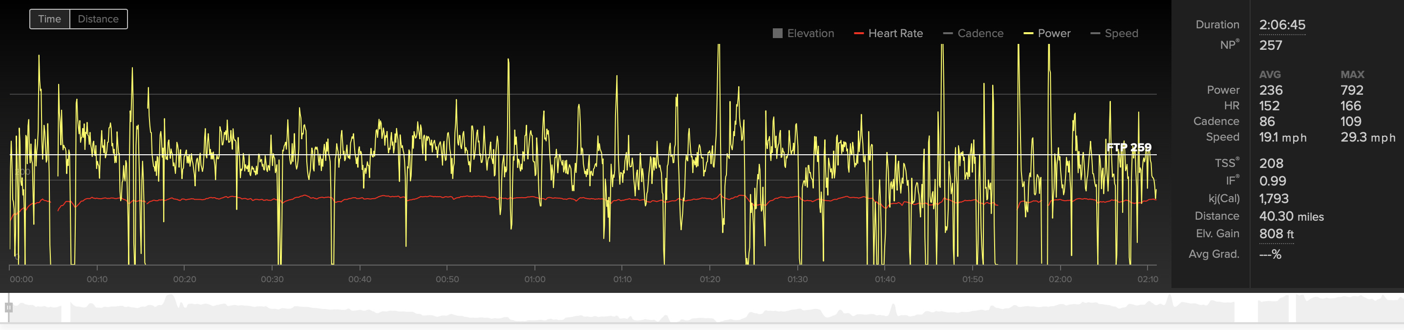

@DaveWh FWIW similar to Nate, I like longer sweet spot and threshold intervals. I have a loop out to the river and back, its pretty much pancake flat as our house is 60’ above sea level and the river flows into the SF Bay.
This is my natural conclusion of doing longer and longer intervals:
The outbound leg has 50 minutes of uninterrupted riding on country roads (after 15 minutes to get outside town). The return leg has traffic and stop lights, which makes it harder to keep a sustained effort going unless the traffic lights are smiling on me that day :wink:
My first season I successfully trained for the DeathRide (120miles / 15,000’ climbing) by doing that loop twice a week, at increasing intensity. EDIT: p.s. people actually bet against me finishing, because I “didn’t do enough training in the hills”
