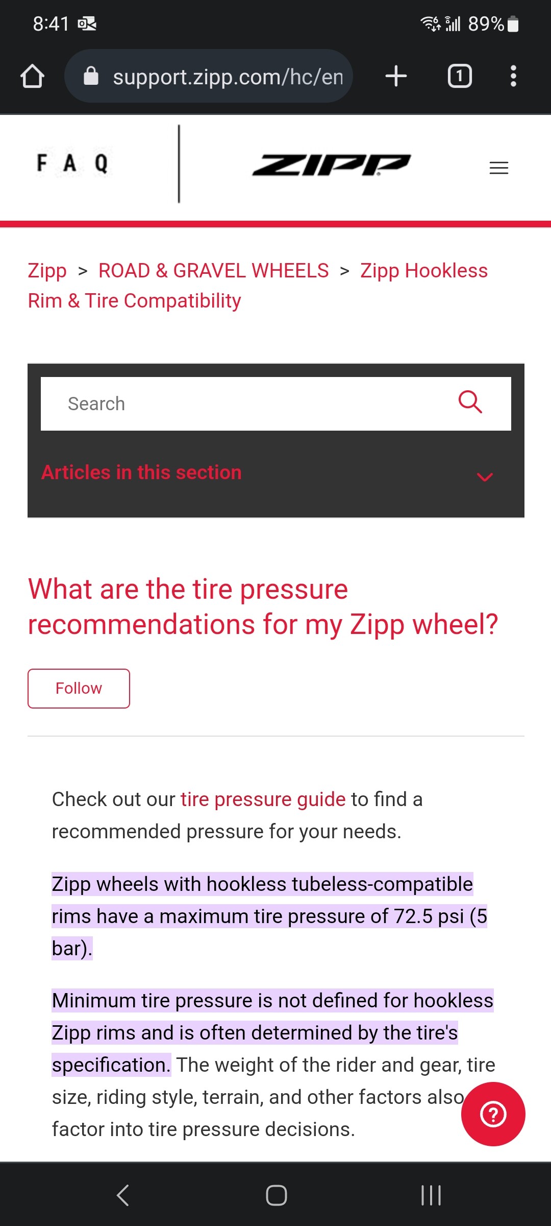

max psi is/was 72.5 on those wheels. as 128lb rider 58-60psi is my norm on 28mm road. but lmk thoughts
Why? Zipp says the max is 72.5 psi.

I ran your numbers in SRAM calculator, I get 49psi front, 53psi back. Besides, what is the point of running tubeless and a wide internal rim if you are going to pump it that hard?
with your blessing let’s stay focused on how and why the etrto updated the guidelines and what ramifications that might have for us all. The psi debate is too subjective and personal to the rider and preferences. 10 calculators will give you 10 different recommendations/ranges and 58-60psi is what felt best for that wheel and tire combo to me. All that said , being well below the max of 72.5 psi means that prsssure shouldn’t have contributed to the blowoff imo.
Yeah but not everyone is small and lightweigth, as a 190cm 81 kg rider i get Pressures of 64/68 for 28cm tires… If you can’t run them at 70psi without the risk of blowing them of the rim then the whole system is badly designed and they need to rethink their whole approach with Hookles and ultra wide internal rims…
