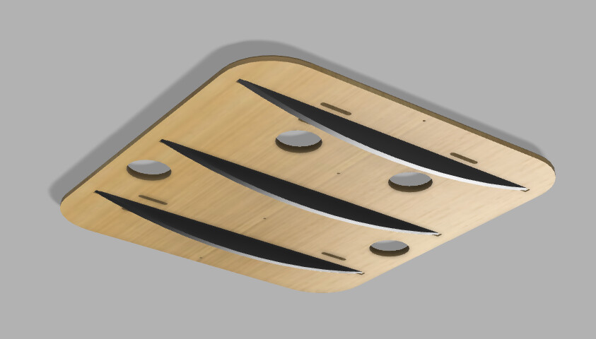

Inspired by lots of great ideas in this thread I went from trainerless and clueless about both trainers and rocker plates to with trainer and with rocker plate over the last few weeks.
Here’s v1.0 just testing dimensions and function with this as it’s just cut from some mdf I had laying around. I made pockets for the ribbed arches in my plans but forgot to change the dimensions to accommodate the thicker mdf I was cutting the test from so the pockets on the top were supposed to be on the bottom. Details. Also seems I could have made the ball holes slightly smaller in diameter but the function of the balls seems good.
First ride tomorrow.
That looks really nice and well made.
Can’t wait to here your feedback after the ride. :smiley:
Thanks, I cheat a bit like some others in the thread. I let the computers do the heavy lifting.
With any luck I can help out some locals with some options in the city for these rocker plates as I see shipping costs are prohibitive.
Wait. Tell me more about that cutter.
It’s a cnc router, just a home job but still quite impressive for what it can handle and really a perfect tool for projects just like this. Mine is an openbuilds lead machine.

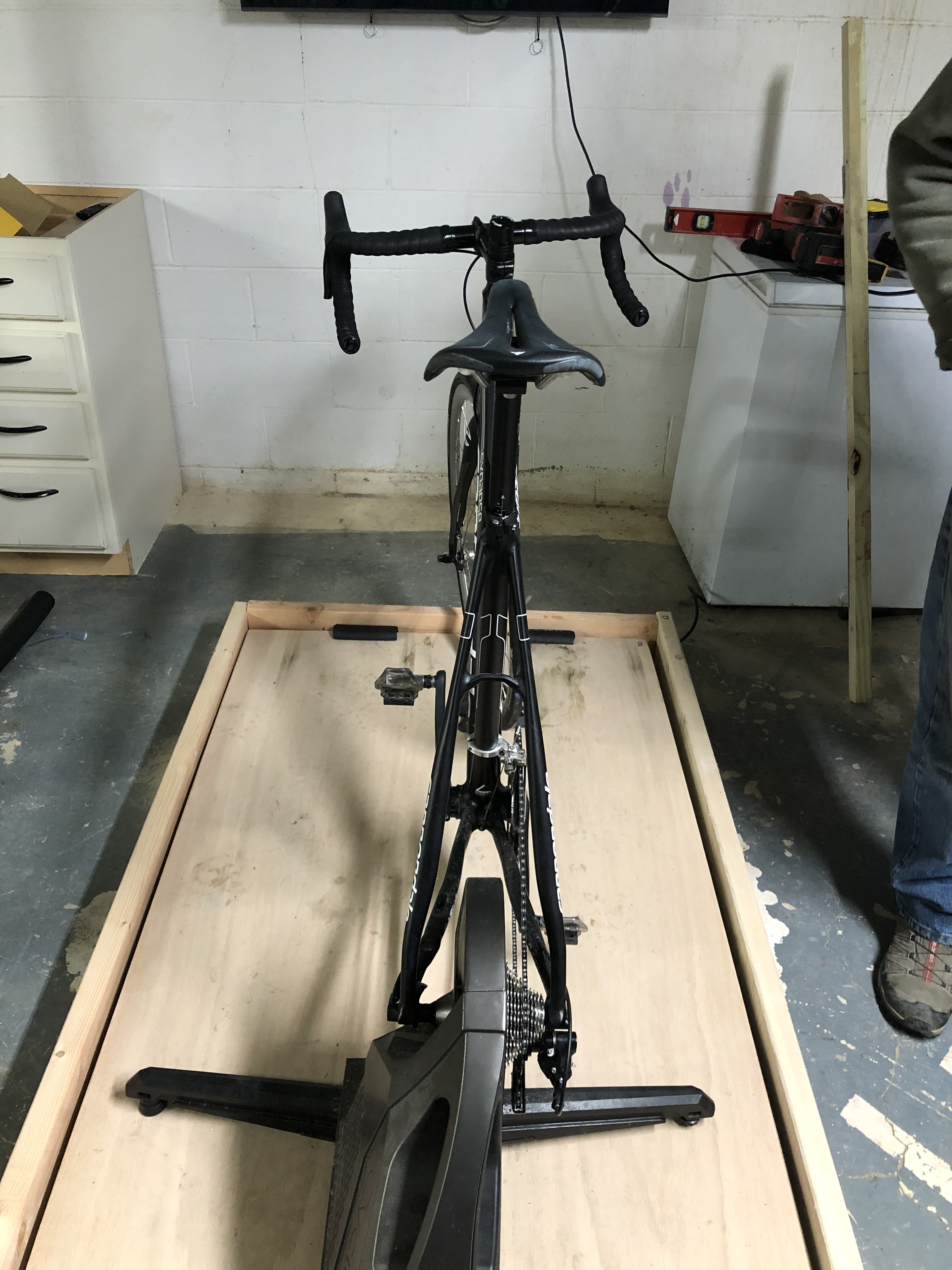

This thread is great! Set up my Kickr on a very simple rocker system. Seems to work pretty darn well. Gonna test it out on a 50K ride tomorrow on Zwift!
As you can see, there isn’t too much space, so I just used two inflatable balance pods on each of the outside legs. Under the base, I used some wood shims. The shims worked well to get them evened out between the front leg and the base in the back. I’ve since taped the shims together so they stay in place. It seems pretty stable as well.
There’s a pretty good amount of rock for such a simple system. I should also add that I have the Kickr Axis attachments on the front leg and back base. They’re a softer rubber than the original front leg and base supports, so I think that helps with the rock on the two side legs positioned on the balance pods. Being short on space in the area my trainer is located, next to my wife’s trainer, I think this system will have to do for now. I’ll let you know how I like it after my longer ride tomorrow. It will be my longest ride on Zwift so far! Thanks for the ideas and inspiration!
That looks really good. That setup in particular will be decent since the center is mostly rigid and just leans. I think it will make a notable improvement over the original Axis feet for comfort and overall action.
Let us know after the ride. Have a great one. :smiley:
Rode my longest Zwift ride with the basic set up above. The natural rock worked well and definitely helped with the long ride. Although my sit bones did hurt for a short bit toward the end and then felt better. That said, with the above set up I did try to get out of the saddle and crank hard for a short bit. That didn’t work at all! My trainer almost came completely off one of the balance pods and slipped off the wood shims under the base and front leg. I had to hop off and fix it while I was coasting downhill! :astonished: If I want to get out of the saddle I’ll need to figure out a way to secure the balance pods on the outside legs and the wood shims to the base and front leg. As things are right now, I just don’t have the space where my trainer is located to build a proper rocker plate on top of the balance pods. Perhaps even some tape connecting the pods and shims to the trainer might work. Part of the fun is continuing to look for ways to refine things!
