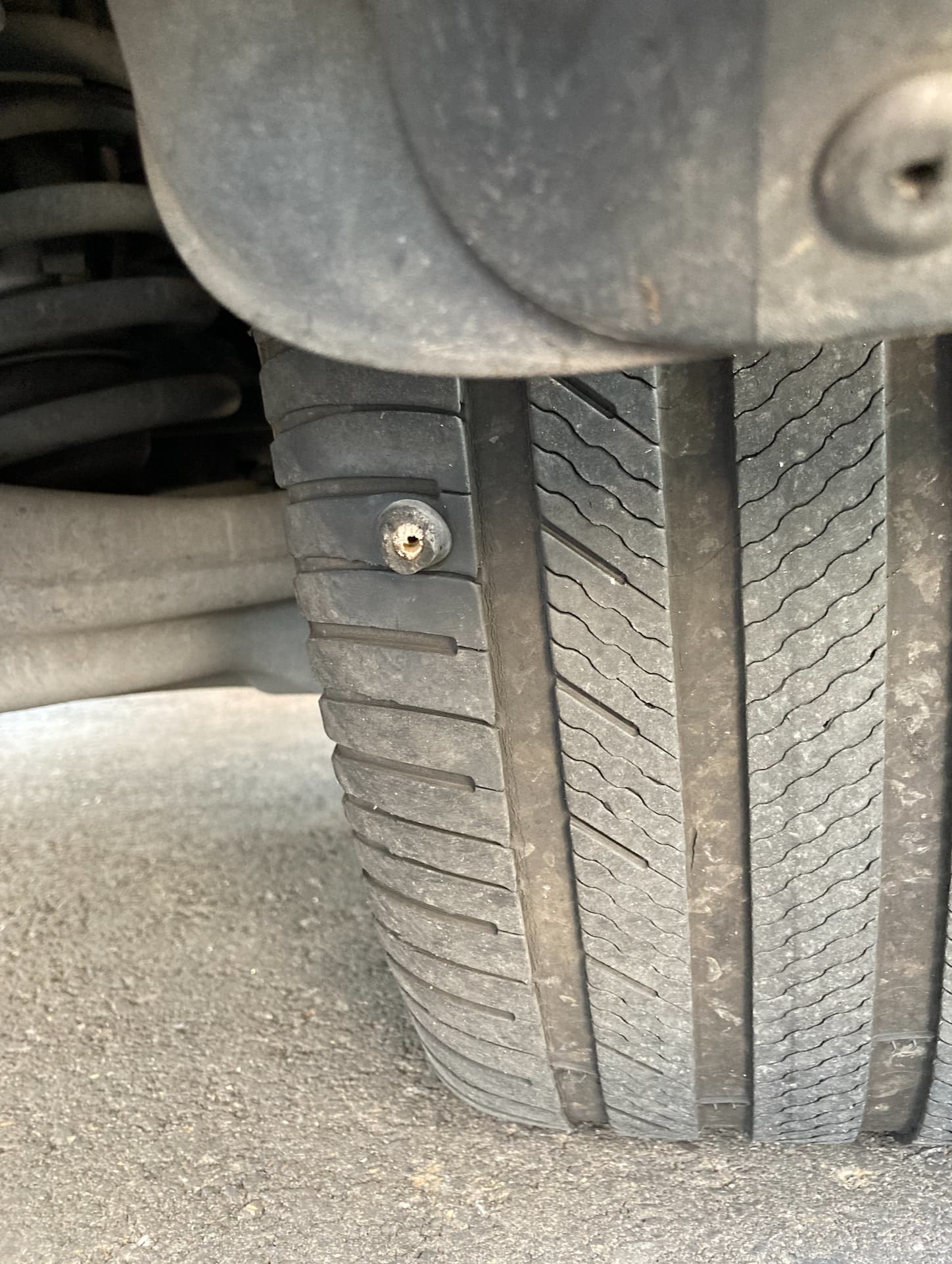

First ‘road tubeless’ fail since getting my drivers license during the disco era and Carter administration :joy: A couple years ago we sold our sedan that had no room for a spare, and of course I included the car tubeless repair kit - sealant, plugs, and compressor - when it was sold. Sure could have used that on Saturday!

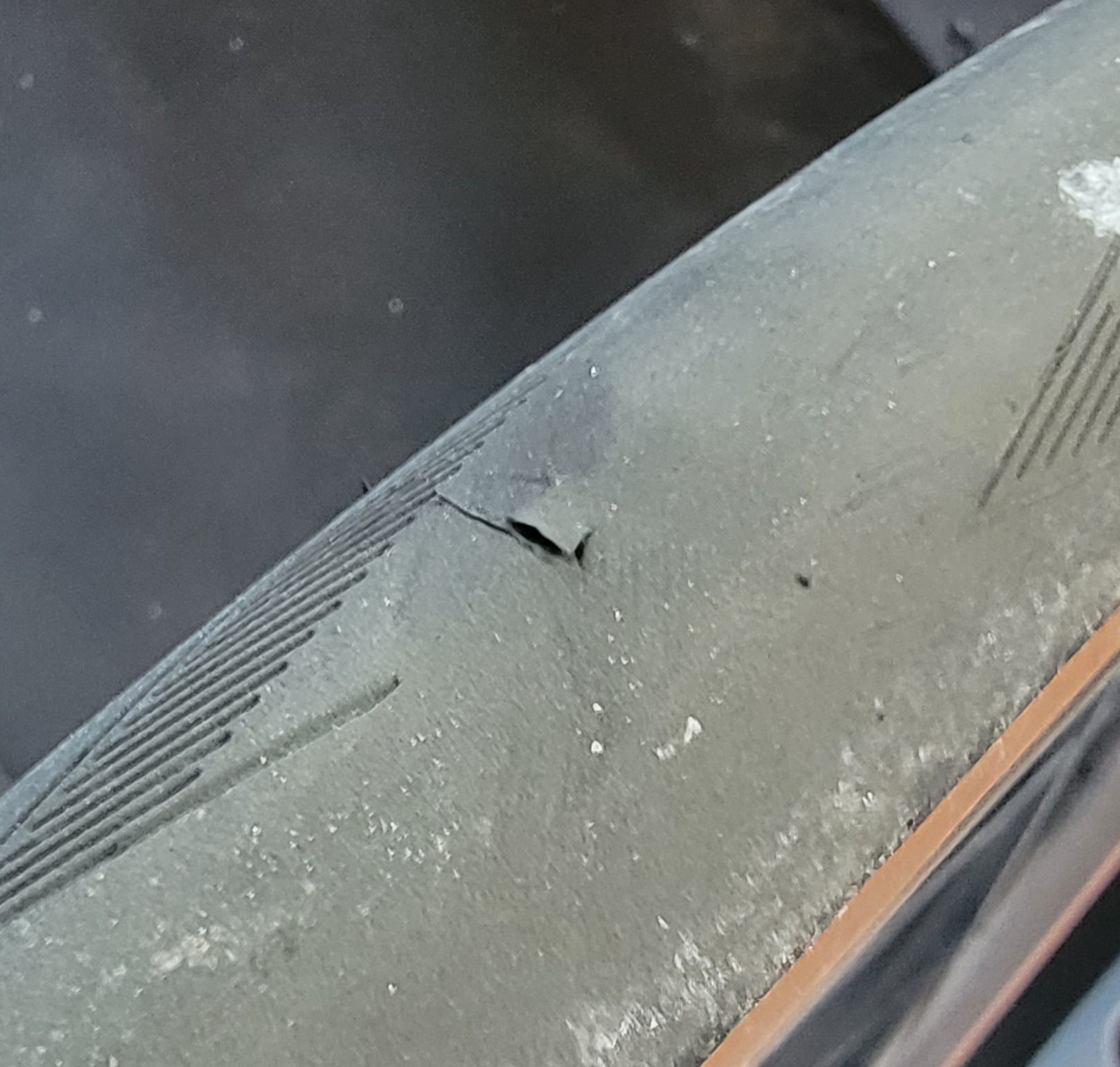

Hoping someone smarter than me will chime it. Roads in New England are crap right now with debris, pot holes, etc. I’m running Schwalbe Pro One 700x32 tubeless and found this today. Either the sealant is working, and/or the cut wasn’t too deep, but should I worry about this? Wondering if I can seal that with superglue? Any tips appreciated!
@FrankTuna - If it were me I’d most likely replace the tire. If it’s on a B bike/wheelset I might put a Stans Dart in it. However, it just looks really compromised.
To me it looks like nothing, just a small cut in the top layer of the rubber that didn’t go all the way through. I’d peel it back to inspect.
I’d also probably superglue it down in place and ride it.
That was the case…just the top layer and it was a little flap of rubber. The tire never lost air with that little cut. Used Shoe Glue and it bonded perfectly. 100+ miles later no issues.
Ha! I didn’t realize this was a bump from a month ago. :slight_smile:
