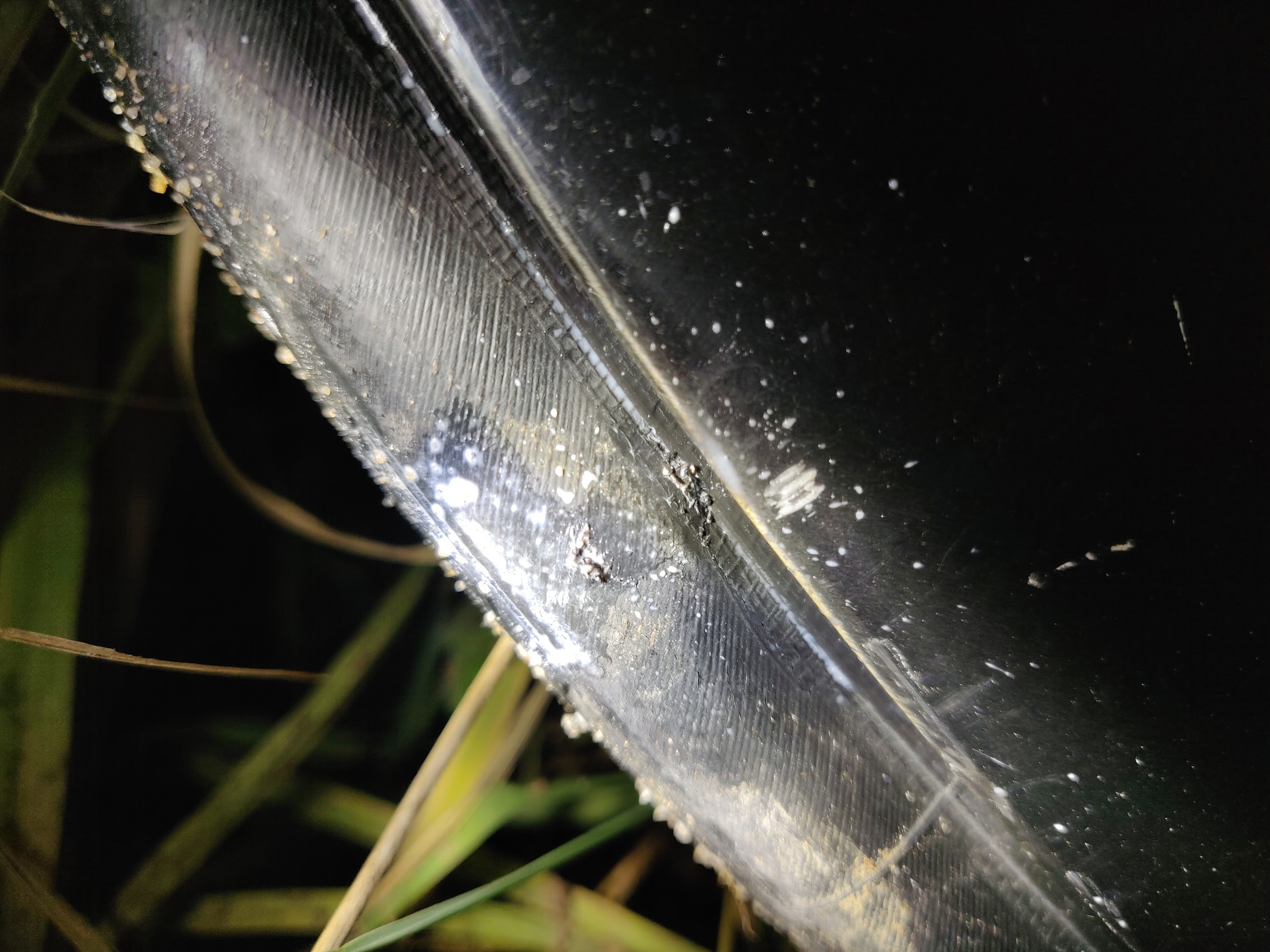

Here is a pic of a tubeless tire that would have received 20 flats in 2000 miles:

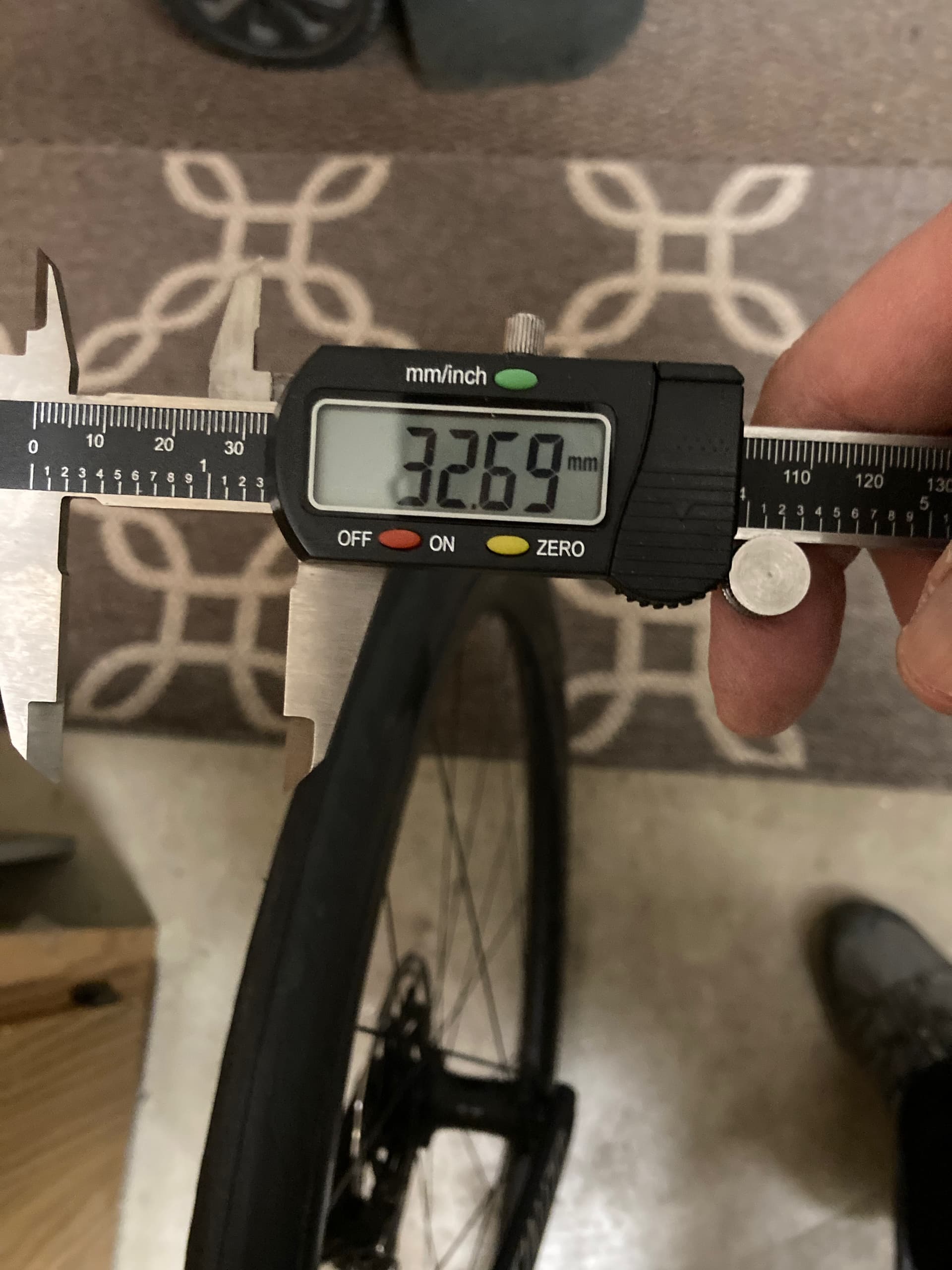

For a winter tire I’m trying the Pirelli P Zero Velo Race TLR in 30x622. Mounted tubeless on the Aeolus Pro 3V wheels tonight, with the Vittoria Air-Liner (L) inserts.

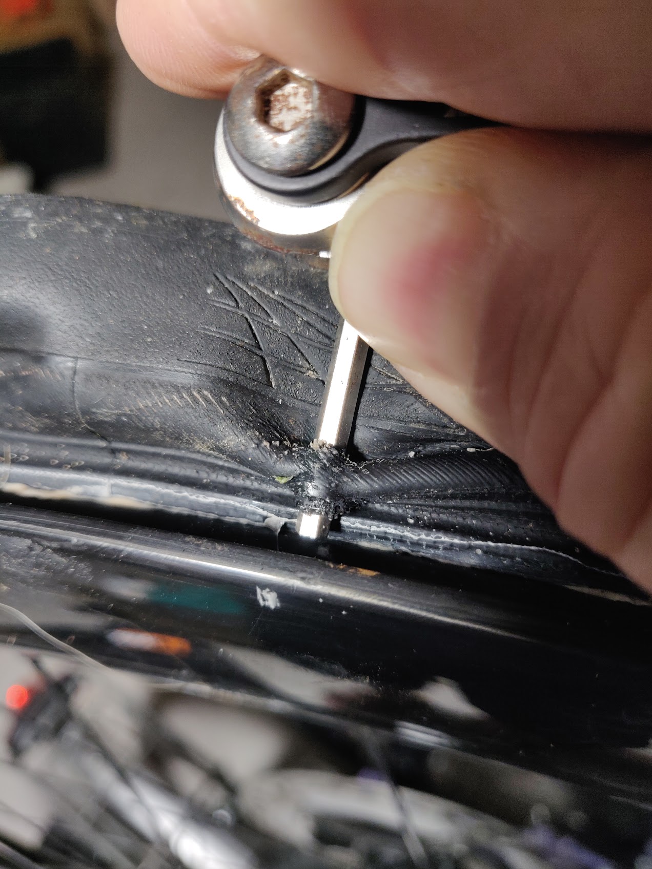

Riding at night yesterday, 0C the whole ride, I got into a bike path, was cruising along at about 30 kph, when all of a sudden I felt a hard bang and heard the air leaving my front tire in a quick fashion. In the middle of the path was a fist-sized, squarish rock, about the same color as the path, so I didn’t see it. Inspected the front tire, found two gashes in the sidewall. I only had one Dynaplug with me (somehow the others fell out, haven’t found them). I managed to thread it through both gashes and tried to pump it up, but the holes were just too big, the sealant sprayed right out. For the first time ever, had to get out the phone and make the Call of Shame, asking my wife to pick me up. Ordered a new front tire today, bummed since I just put this one on in September, barely broken in. On top of that, Conti discontinued the “regular” original GP5000TL that was about 40-45€, and replaced it with the “S TR” which costs 70-80€. Found a place that had a sale at 55€, still annoying that they’ve gotten so expensive though.

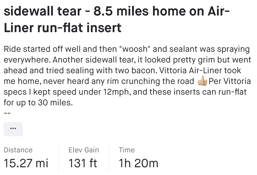

that is the cycling life I aspire to, sadly these are the types of Strava exchanges that happen after Tuesday’s sidewall issue on new tires with only 400 miles on them:

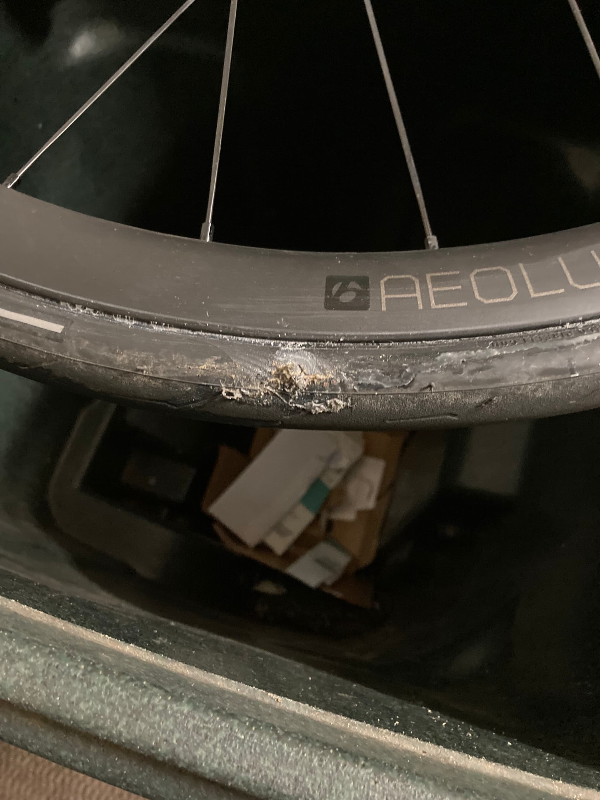

Good news is I put the ‘old’ 5000 TL front tire with 1800 miles on the back, then one I took off 3 weeks ago after a sidewall issue with the back tire. Going to get my money’s worth on that one.
