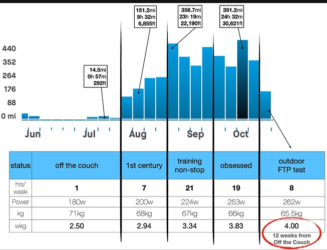

Hi op. Your question got me curious so I dug into my own data.
Took me 12 weeks to go from Off the Couch => 4.0wkg.
Caveat:
What works for me won’t work for others. Response to training is highly individual.
Please take what I am sharing as a singular, individual, (n=1) anecdote.
A lot of this has to do with genetics, motivation, and what your lifestyle can accommodate.
Starting Profile:
Was in my mid-20’s.
The most exercise I was doing was 1 hour per week, commuting to office work.
5’6
156lbs (71kg)
NOT lean when I started.
How it Started:
Friend invited me do my first 64 mile Fondo one day. I got hooked.
The very next week I did my first 100mi ride, and then I started riding like crazy for the next few months.
Training Plan:
Didn’t follow a plan. Just riding around solo, exploring new roads during all the free time I had.
Went hard up as possible every hill. Tempo or leisure pace on flats. Sprinted out of every green light.
Highly unstructured, and just riding as much as possible.
Nutrition:
On-Bike: I didn’t take food on the bike. I had no clue what I was doing. I didn’t have bottle cages on my first century. I’d stop at gas-stations for chips, soda, and sandwiches.
Off-Bike: Eating as much as possible off the bike. Nearly all of it junk food: McDonald’s, takeout, fast food. Beer, wine, Gatorade. It was convenient, and high in calories. The only bike-related research I really did was watching GCN with my legs up during the Golden Era when it was the original presenters.
Summary:
As you can see, my training was random with no rhyme or reason.
Lots of volume (+20hrs/week), with intensity naturally sprinkled throughout the ride with hills and stoplights.
Power distribution is Pyramidal.
HR distribution is Polarized.
Again, a very lucky situation in my mid-20’s after college. No commitment and lots of free time.
I didn’t take great care with rest, recovery, or nutrition. Didn’t lube my chain for months so riding my 350mi weeks on a screeching chain while wearing baggy kits and shorts instead of a bib.
Today:
That was a VERY long time ago.
Well, I am happy to report I am still obsessed with training today.
But now, everything is measured and it’s a lifestyle.
  • I am extremely careful about planning out my rest days, so I know which days I need to go hard.
  • I take recovery weeks once a month or so.
  • I take 2-3 full weeks off the bike once a year or so.
  • I prioritize consistency above all else.
  • But if I miss a workout I know how to fix it.
  • I now do bike-specific gym work 0~3 times a week, based on time of season.
  • I macro-count off the bike.
  • I still measure my weight half a dozen times a day.
  • I plan out how much sugar water goes in my bottle, and consume 30~90g/hr depending.
  • I obsess over marginal gains on my equipment and kit.
  • Waxed chain, optimized Crr, aero bike fit with CdA measurements, all that.
  • Multiple bikes, each optimized with different gear-ratios for different terrain.
  • But bike is hilariously still pretty heavy.
I do about 6~12 hours a week now, and can hover around 3.8~4.0wkg on low maintenance.
Thank you for coming to my Fred Talk.

You had a power meter and hr strap but no bottle cages???
Ya nice catch was waiting for this one.
I did the exact same 50minute mountain 2-3 times a week, which ended up becoming 30minutes by the time I was peaked. If you look at my elevation I was doing many other 3~18 mile mountain hills which I can cross-reference using known time and weight.
Used bike calculator and/or Gribble to compute back watts.
Wind’s not a big factor because these grades are +8%. And even still, I do so much Rchung analysis now that I can look up historical wind reports to subtract or add back in estimated wind data if my calculated watts looks really off.
tl;dr, given how much data I have over ~10 years on the same sets of hills, over various seasons, it’s really easy to cross referenced calculate estimated watts with real PM data.
