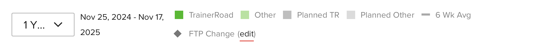

Below are graphs with more granularity for the last few months and then expanded for the past year. We relocated from Texas to Washington in early October and slowed down during that busy period.

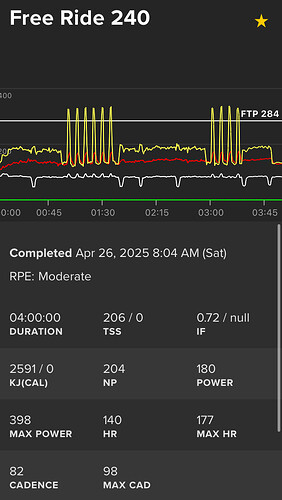

Up until the last few weeks, my training has always been focused on polarized. Threshold/vo2 and then Z2. My Z2 was often at like .55-.6 IF, which looking back, I think was a bit TOO easy. I’m currently in off season but am admittedly pushing a little too hard I think. I’ll dial it back a bit in December and maybe part of January, before attempting to ramp up.
During my harder in season training you’ll see targets were typically 400-500+ TSS. Right now, around 300-350 seems solid for off season. I usually follow a 3-4 week “on”, then a week of mostly Z2.

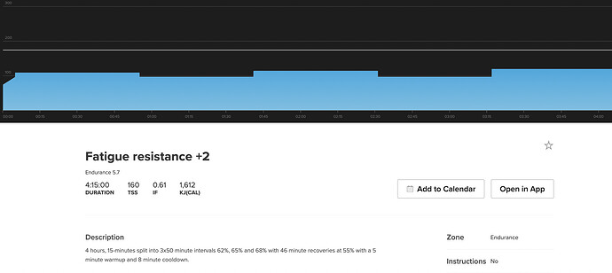

It was actually the TR podcast a few weeks ago with Keegan that convinced me to swap out a threshold/VO2 ride for SS, and also to increase Z2 intensity for the higher part of Z2 as a way to get more TSS on the less hours.
