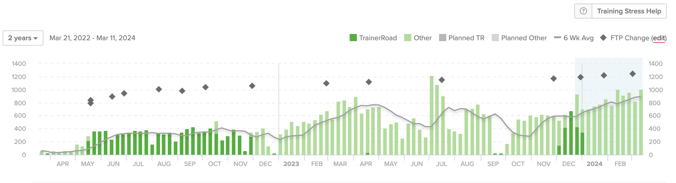

My last two years (22 months). Started riding again (after a year off), TR may 19, 2022 (was probably over 100kg, 239 ramp test ftp). mid volume - Burned out in Dec (rlgl went nuts, but I did make good gains before the wheels came off). January my own thing for a while, long z2, zwift. In july did what I called the old fat guy vrtual half tour de france (3 hours riding zwift every day the tdf was on, with climb portal climb efforts to start every climby day, sprints from robopacers on sprinty days).
got Covid in Sept. Rode easy in oct/nov and tried to drop weight. Started mid-December trying to ramp up the volume.
Today, 88kg, ftp 359.

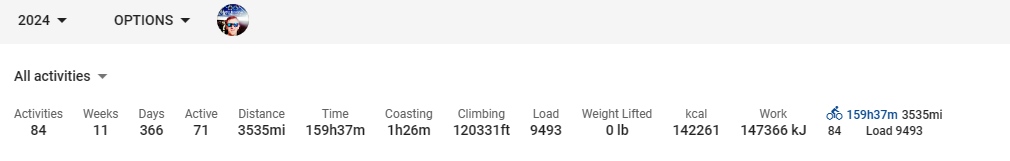

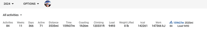

22 months, 951 hours.
intervals.icu data, 2022 was 87% z1/2 (not sure this is reliable), 2023 92% z1/2, 2024 classified as “threshold”, 50+% z1/2 ~43% z3/4 and like 1-3% z5.
2022
2023
2024
I currently have a ctl of 120+, last week was 16.5 hours, and 1010tss.

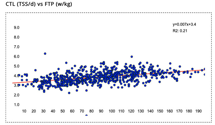

This has been posted before, but there’s a very interesting Alan Couzens blog post about FTP and CTL. Volume vs Intensity | Alan Couzens
Bottom line: the ‘average’ guy will take a CTL of 100 to hit 4w/kg. Simplifying, that’s 700 TSS per week more or less in perpetuity.

Thanks for sharing, that study is pretty much dead on for me. My CTL will typically max out about a month before my A event at ~100 and my FTP will be right around 4 w/kg, maybe as high as 4.2 if I’m disciplined on my diet/weight. I guess that makes me an average responder to training, but maybe a bit above average for my age group since I’m in my mid 50’s. I never got close to 4w/kg back when I was doing <400 hours a year even though I was younger.

I love that post, and it’s really cool to see the data.
It’s worth noting though that the total variability of the trend line (which runs from ~3.2-4.5 w/kg going from no to lots of CTL) is much smaller than the variability at any specific CTL value. Relevant to this post, drawing the horizontal at 4 w/kg shows folks with basically zero CTL hitting that number, and folks sub-4 w/kg on >150CTL.
All to say, training more will definitely make you stronger, but 4w/kg is not a given, and there’s no magical amount of CTL that can guarantee that (or any) number for all.
I guess the real punchline is. If you want to know if you can get to 4 w/kg, get to 100+ ctl and see: 1. How close you are and 2. Do you REALLY want to get to 4 w/kg?

If @the_cog were still here I think he would get a fit if he saw that graph like that. You cannot compare ctl between people, this graph only shows the ctl by w/kg not the other way around
The R^2 is only .21!! That means that CTL only explains 21% of the variance in w/kg among athletes. I wonder what variable(s) could be added to get a better fit. Also it’s hard to tell just by looking at a picture of the chart, but I think there are significantly more data points below 4.0 w/kg at 100 CTL than above.
Plus there is that one dot on the chart with a 30 ctl and a >6watt/kg! They had the right parents.
