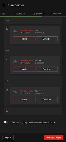

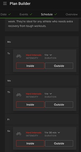

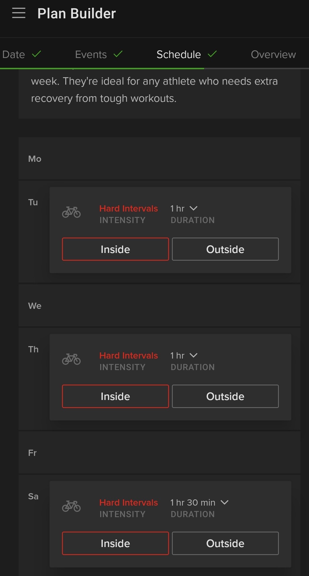

Use the custom plan builder. You can select the lenght of each workout through it.
The screenshot I posted in reply to @gally24 is of the custom plan builder.
Keep going through the builder, it will allow you to change the time of each workout and what day it is on.

Nope. You can change the times in plan builder.

Yes if it is plan builder, click on the block name invthe calendar and set your default durations for the block. All my work outs are set to 45mins.
