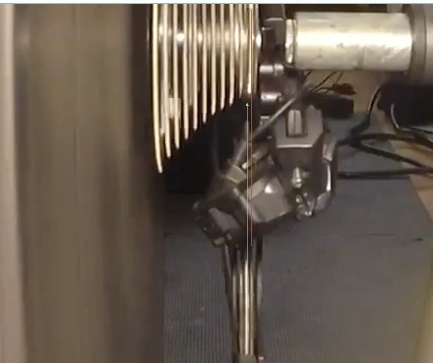

This only happens when I ride my disc. I tried adjusting the limit screw and rode outside this morning…still happening. Can someone tell me what to do? This doesn’t happen on my other wheel set. You can see the jockey wheel jumps, but only in the smallest cog
Seems to happen once a chain revolution. Seems like you’ve got enough space between the pulley and cog. Chain seems stable on the 11t.

I’m not sure if you’ve tried this but from this angle, it looks to me like the rear derailleur could use a couple of clicks of adjustment (hold junction box button for 2 seconds until solid red light, give the small paddle shifter on right 2 or 3 clicks, press and hold junction box button for a few seconds until the red light goes out). Also could be complicated by a rear derailleur slightly out of alignment (even though it looks pretty good from this angle).

Have you put an alignment gauge on the hanger? It doesn’t look out from the video perspective but it would be the next thing I’d check on my bike. From the video, it wouldn’t think the high limit screw is the cause. I can see the derailleur do its programed over-shift and settle back to its indexed position.
