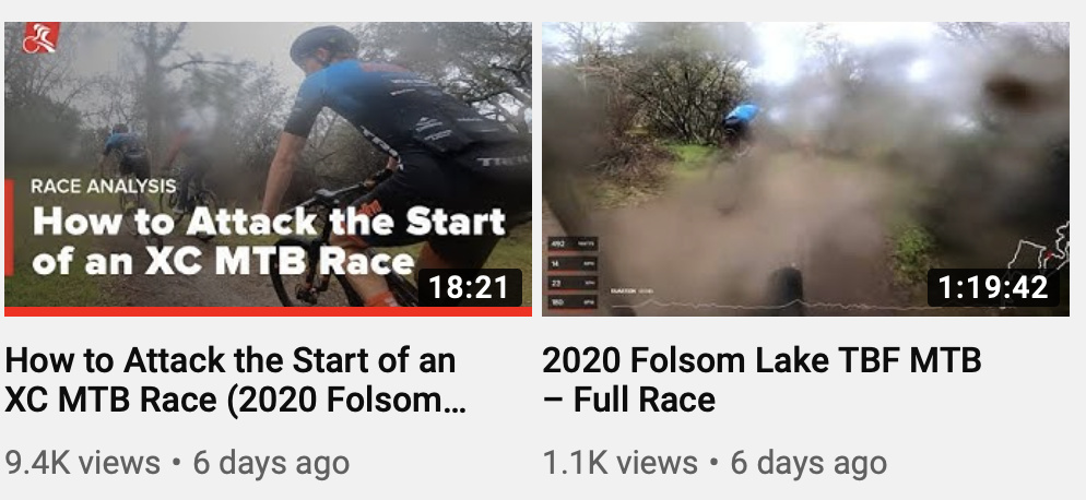

I have gotten through about half of the video. But check your time – the entire thing is only 18 minutes long.
two videos, the full race is longer:
