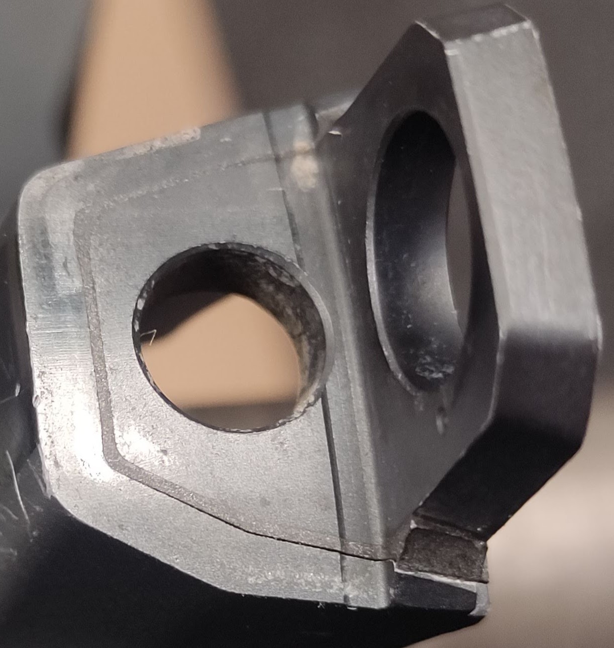

Today’s crank inspection. FC-6800 this one.
I can feel a step between the bonded surfaces and when I zoom in I can see that the bond is different across its length.
Bond looks broken

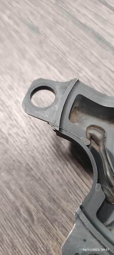

I’ve received and fitted my replacement shimano crank after my original 6800 crank was confirmed to be showing signs of delamination.
One thing I’ve noticed with the replacement FC-08 crank is that it isn’t balanced like my 6800 crank was.
I.e. after I fitted without a chain it will always settle with the drive-side crank arm facing downwards. This isn’t the case with any of my rotor cranks and I don’t think it was like this on my 6800.
Has anyone else noticed this? Am i mis-remembering what my 6800 was like? Is it even the slightest issue? ![]()
So about a year and a half after passing inspection, I started to hear a creaking noise when pedaling hard and found that one of the bonds had separated on my 6800 crank. I took it into my shop and less than a week later I have the new FC-08 warranty replacement crank from Shimano. Fortunately it didn’t fail while riding.
