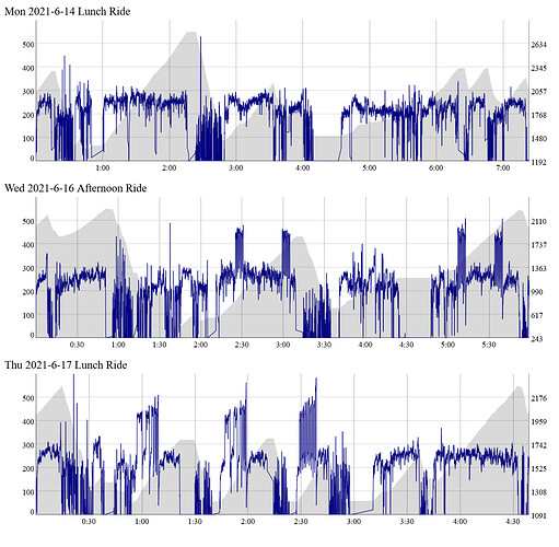

Jumbo Visma, Dauphine, then 2-3 days easy and then off into the final pre-TdF team camp.
It’s interesting to see how similar those mountain days at the Dauphine and the team camp rides are. They simply replicate this tempo/SST grinding in training.
