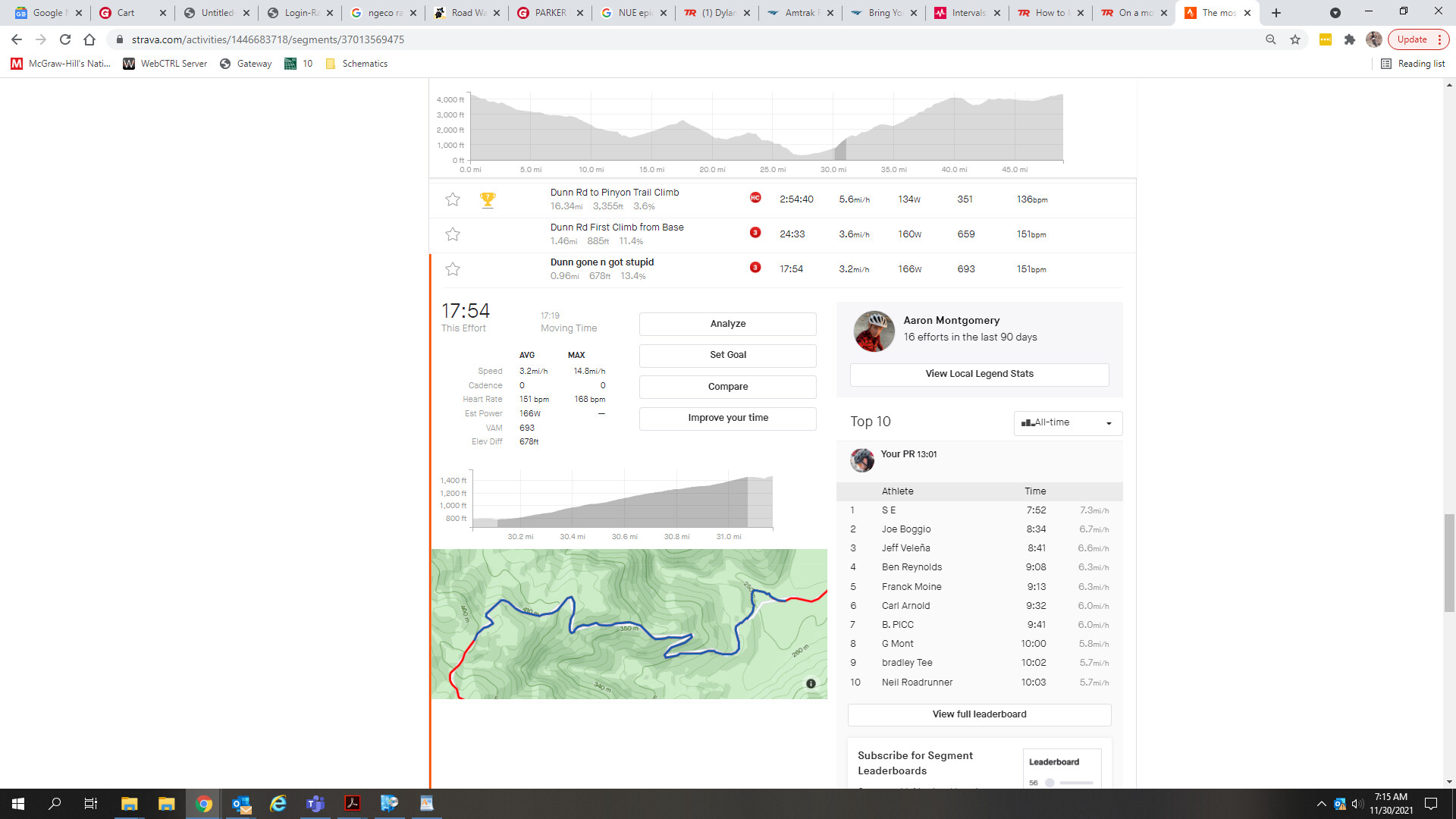

I lost most (if no all) of my KOM’s on this route last year to a local fast guy. 6.8 KPH on this segment. But also probably not ridden a lot:
