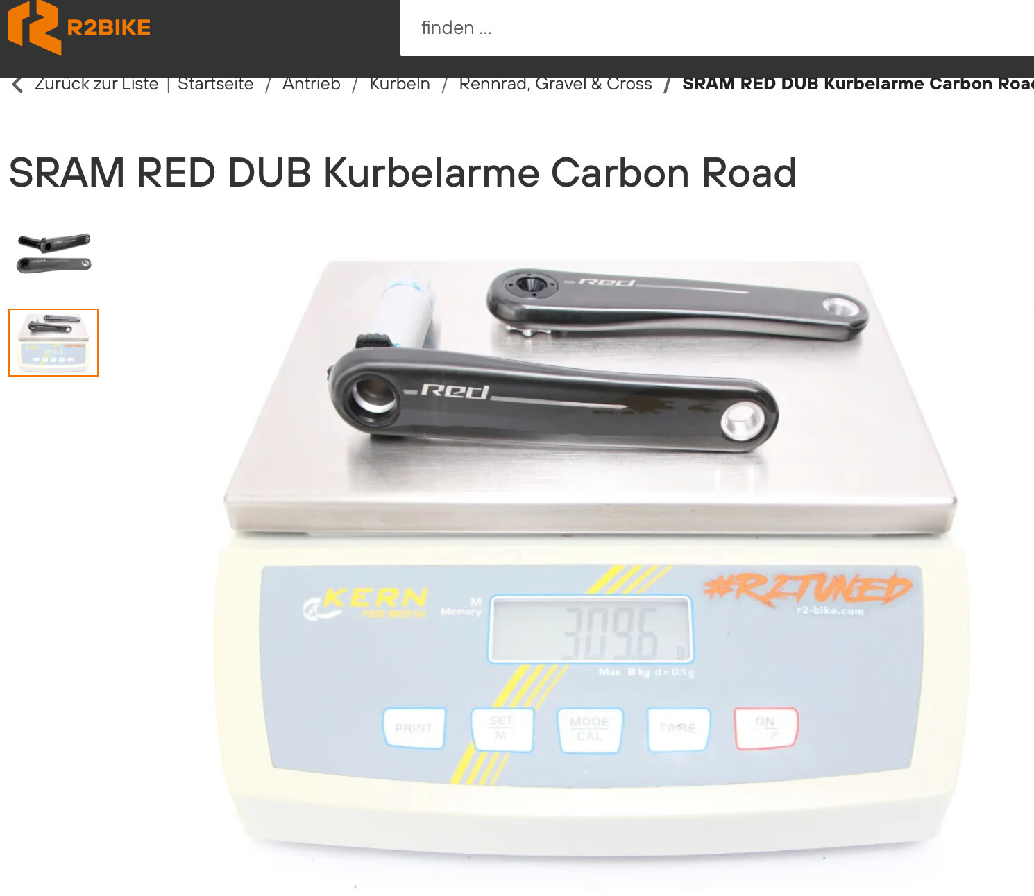

Anyone know the weight difference between a SRAM Red E1 crank arm set and SRAM Force for the same?
Just the arms with standard road DUB spindle not wide. No chainrings.
I tried researching multiple sites starting with SRAM but came up empty or found discrepancies between sites.
Weightweenies crankset listings appear outdated and there are no SRAM crank arms listed at all.
Essentially, I want to know if there is a significant difference between the crank arms or not.
There is a significant weight difference from the Red to the Force, and even more so with the newest E1 Red… Around 475g vs 310g. New Force E1 will be a bit lighter than the current D2 version, following the trajectory that the Red made.
R2 is pretty good in stating weights. They measure almost all parts themselves
