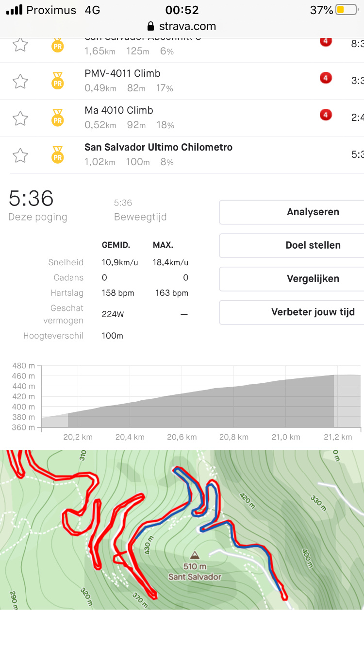

I did not Do a climb yet with pedals.
But Strava gave around 230 w for this climb in Mallorca. I went all in here.
This is the same climb but another part of it.
This is now outdoor on a flat surface. Average bpm 137 (My maximum is 185). 150 plus is really pushing it.

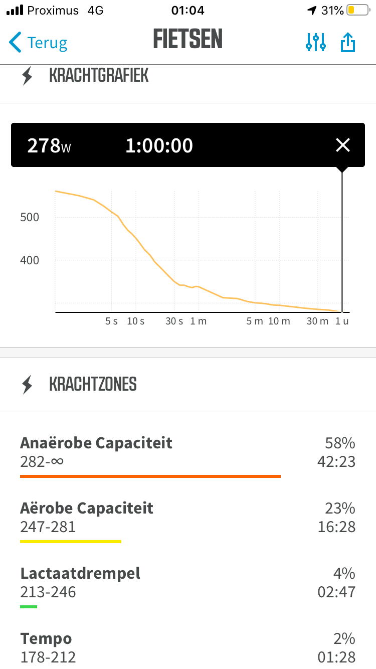

Yeah will Do ftp test with the pedals. I expect about + 275 watt so 40 watt more than the zwift ftp test I did last week prior to vector 3. Will post it later here.

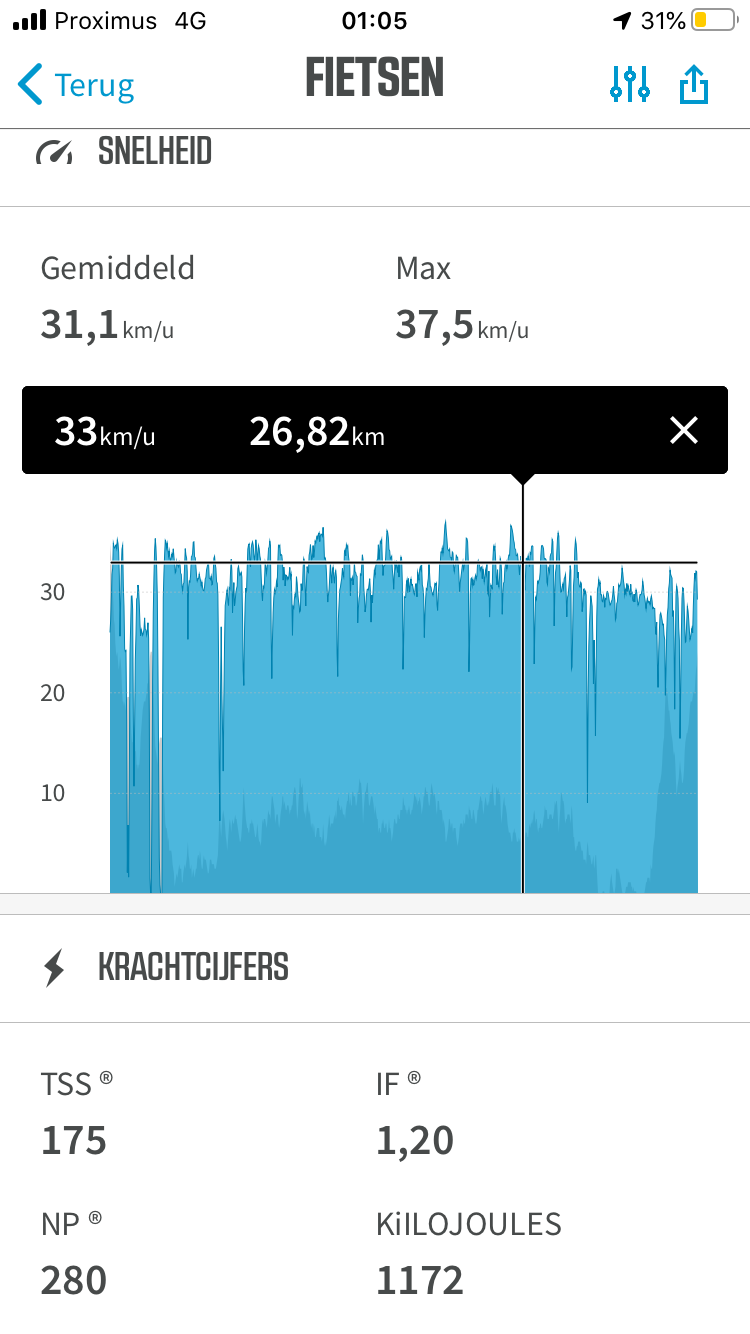

I don’t think the numbers you’re presenting are crazy. 280ish FTP at 83kg (3.4W/kg) generating 33km/hr… speed is really hard to judge: what’s the surface like, how aero are you/your bike, what tires, etc? Seems like that’s all reasonable to me.
Well it was good concrete, did laps around a big lake with canyon aeroad cf sl. Sometimes used aerobars also. Average speed was 31,1 km/h. No traffic or lights almost. Average watt 270.
Continental gp attack with 7,5 bar :slight_smile:
Almost 20mph at 3.2W/kg and 270W. You’re a little bit bigger dude so probably not as aero as me, but that power/speed isn’t unreasonable IME.

If you can solo ride at 20+ for a while I don’t think your FTP is 2.77W/kg. I think the Vortex is likely incorrect.
