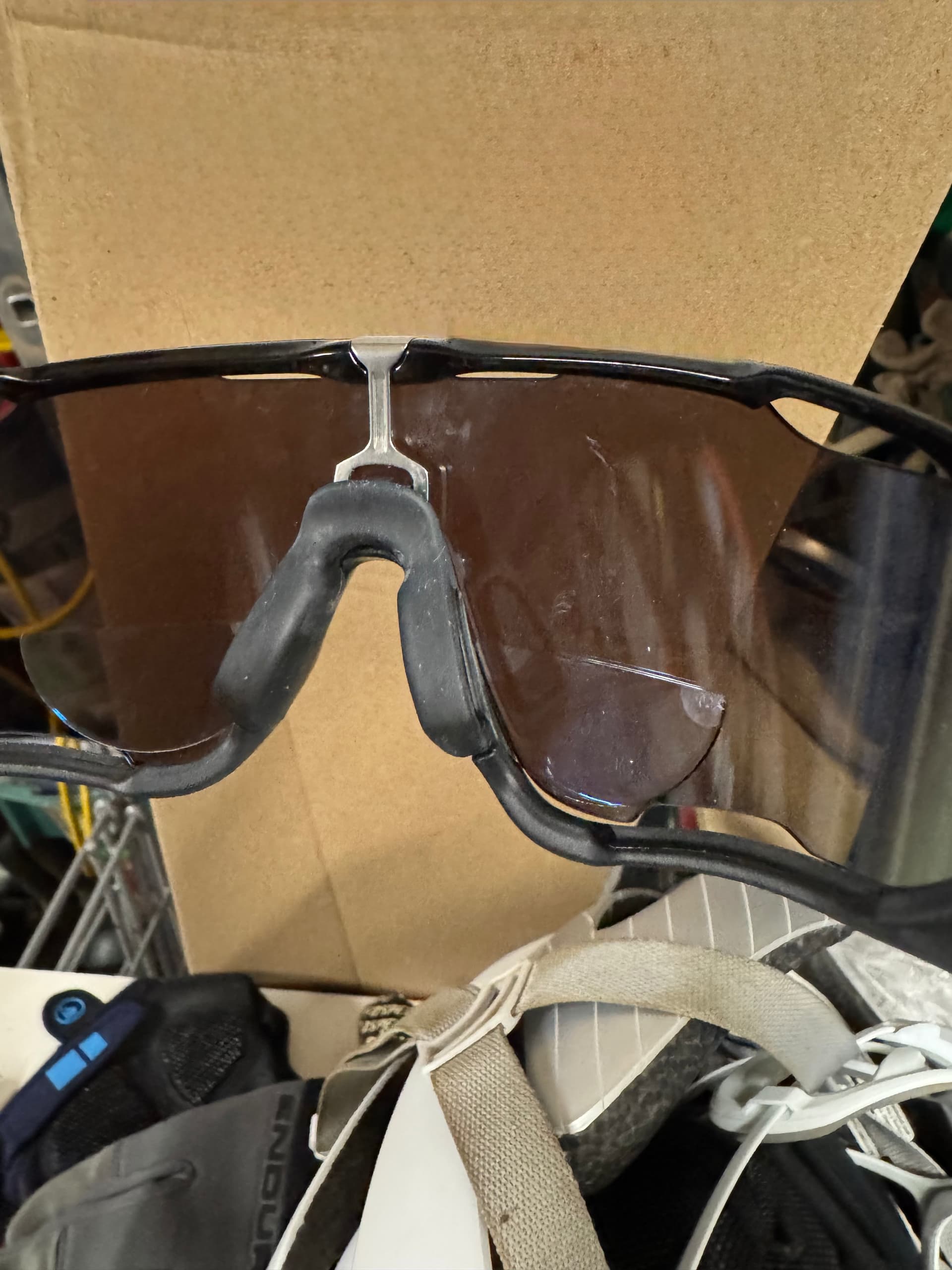

I’ve stuck these onto my sunglasses, so can now read my 840!
Can you stick them on shades that correct for nearsightedness?
Yes. Assuming you have normal single vision glasses for nearsightedness, the stick-on lenses will add power to the bottom of your glasses to allow focusing nearer. This will turn your single vision lenses into traditional bifocals with a sharp transition from distant to near vision. I never liked trad bifocals and have been much happier with progressive bifocals. If you make the near area small at the very bottom of the lenses, this might be a reasonable solution.
Yes that’s what I do to read my garmin
