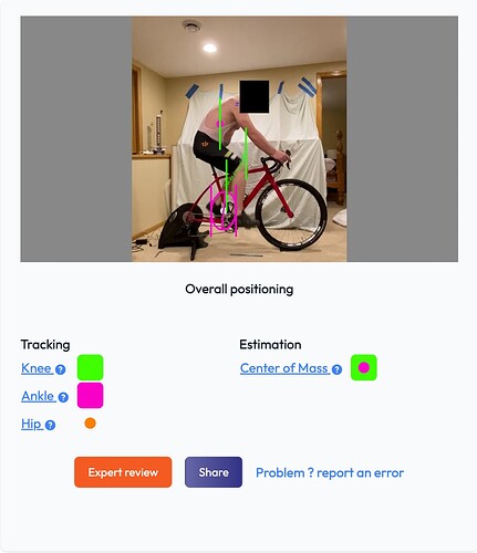

Ok. Going to share the results from my first full (fit cycle) here. Keep in mind that the ‘before’ measurement dates all the way back to last November. The ‘after’ measurements were just taken earlier today. Life and other stuff got in the way.
I did use the $75 buy-up option for human review. Jesse (one of the co-founders) was very helpful. This was my first time doing a bike fit of any kind (beyond the usual salesperson instruction of ‘stand over the bike and let’s see how it looks’). I think if you’re more of a fit novice like me, the $75 human review option is helpful. If you know your fit in and out, you likely don’t need it.
Biggest changes I made were to move the seat forward, drop it some, and spent a lot of time adjusting the bars. According to the factory specs, my bike comes with a 100mm stem (it actually measures 90mm). I’m using a 110mm stem in the after photos.
Here’s the ‘before’, apologies for the lousy background. And my excess pounds around the middle.
Here’s the ‘after’.

I was having lots of pain and numbness in my hands. And didn’t ever feel comfortable riding with my hands in the drops. It always felt akward and uncomfortable. After the first round, Jesse made clear that my hands were way too choked up on the bars. After getting the seat position right, I spend a long time repositioning the brake levers on the bars, adjusting handlebar angle, etc. And experimented with a 100mm vs. 110mm stem. Worked hard to try and draw a straighter line between my forearm and my hands.
Best thing I can say is that the numbness is pretty much gone, and it’s less painful to stretch out on the bike. I’m aware of the fact that my overall flexibility needs improvement.
At this point, I feel like I have a good, basic, bit fit and associated measurements. Aiming to buy a new bike sometime in the next 6 months.

Does the app take a front or back view to suggest adjustments? Or is it just from the side?
Just from the side. I recall hearing somewhere (maybe it was an interview with the founders) that the AI is best able to assess what’s happening from the side profile, and that front view is harder for the AI to interpret.
I’ve never done a fit with the more established fitting systems out there, like Retül, but it was surprising to me how much the various points of your body move around as you’re pedaling. The myvelofit AI accounts for such movement, and they make clear how the AI interpreted the video you upload. So you get a chance to see what the AI is seeing.

I’ve been using the adjusted fit for 3+ months now. I did another round of assessment just last week because I could (one of the benefits of the myvelofit pricing model). But I didn’t make any subsequent changes.
Just did 9.5 hours on the bike this past Saturday and didn’t notice much numbness or pain in my hands or wrists (beyond what’s to be expected from a ride of that duration). Prior to myvelofit, I’d start experiencing pain within 20-30minutes of setting out for a ride (same bike).
So in the end, moving the seat forward about 10-20mm, dropping it 5mm, lengthening the stem by 20mm and spending a lot of time adjusting the rotation of the handlebars and the brake lever position on the bars all did a lot for my comfort.
