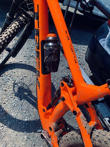

Maybe i can find an XR3 and pair it with the existing XR4 I have up front. I don’t want to go too XC leaning for a tire since I don’t really have an XC bike (fuel ex, not top fuel) so seems kind of silly to put race tires on a party bike. Then again I don’t really know if the XR3 is a true XC tire, maybe light trail?
Weight wise the XR3 is only 35g or so lighter than the 4 so also not sure if that’s enough to care about
