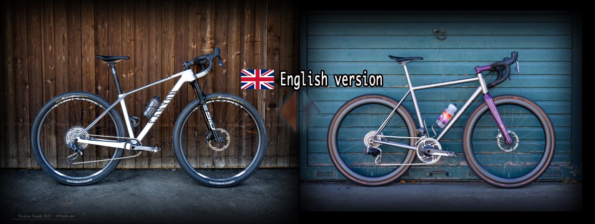

That guy’s blog is great. In this other article, he says what I’ve been thinking for a few years now every time I read a Jan Heine article:
Unfortunately, unfortunately – with all the knowledge and experience that Jan Heine and his team have acquired, they are clearly neglected on the topic “sufficiently large test length” on the topic just mentioned. Time handling with normal stopwatches and measuring lengths for only around 15 seconds lead in the graphics listed there as an example between 700Cx44 and 700cx28 tyres at times in the range of exclusively 15.x seconds. And in the range from 15.19 to 15.70. Here, differentiation is still foremost, due to the extension of measurement errors, even according to the means. Well, Jan Heine wanted to show that there are no differences between the two tyre dimensions.

That’s a really nice article, I enjoyed reading that. I did some similar testing myself last year, using the Chung method to compare the relative performance of my MTB with 2.35” Thunder Burt tyres, to my cyclocross bike with 40mm Conti Terra Speeds, ridden around a grass field. The full blog post is here.
The method I used for that Chung testing was very similar to what you described in your article. For the analysis I fixed the CdA, CRR and weight for both bikes (although they were obviously different for all three of those parameters). Then, the difference in the virtual elevation profiles indicated to me which bike is faster. That difference might have been be due to CdA, CRR, or weight, and probably some balance of differences in all three. With Chung testing it’s sometimes possible to differentiate where the overall net benefit is coming from, but in the end, it doesn’t really matter, as we normally only want to know whether one bike is faster than another, regardless of the reason.
I found that the MTB was faster, presumably because the improved rolling resistance of the wider tyres had a greater effect than the aero penalties coming from the flat bars, the suspension fork, etc. All the testing I’ve done in recent years persuaded me this summer to convert my hardtail to a drop bar rigid MTB, like you did for your Canyon Exceed, which I now use for any dry cyclocross races. It gets me better race results than I get with my 33mm-tyred cyclocross bike (we don’t have tyre width rules in our local races).
