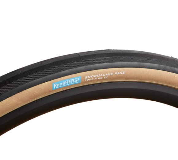

  1. RH Extra-light Slick 44mm

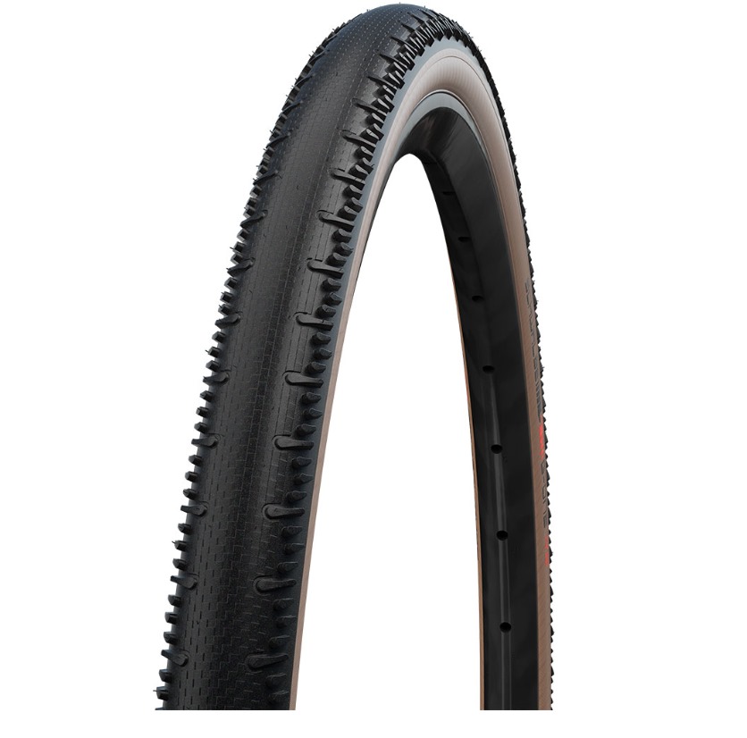

  1. Shwalbe GS Race

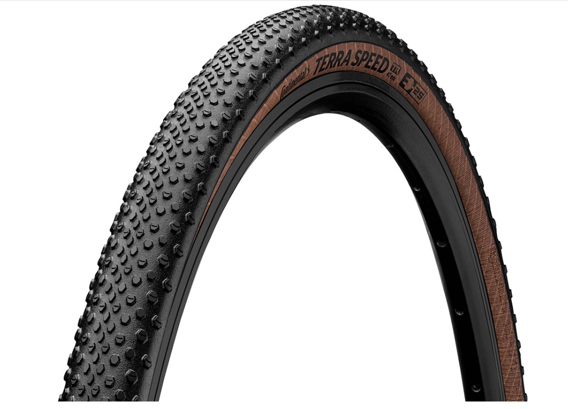

  1. Conti Terra

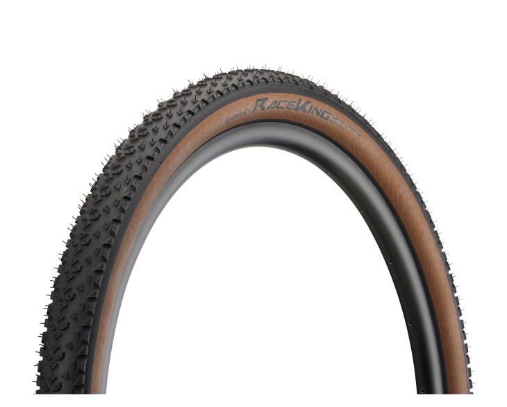

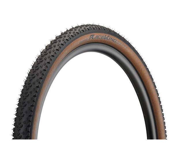

  1. Conti Race Kings

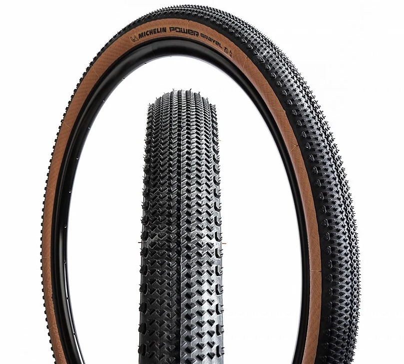

  1. Michelin Gravel Power
This is a good comp for the Rene Herse. Harder to install but just as fast with better grip and significantly better puncture protection IME. I use them as my road tires.
I’ve used a few different Michelin MTB tires and they wouldn’t be in the running if I had to pick fastest gravel tires, how’d that one end up on your list?
Yeah, of those five you came to, two of them are non-starters for me, as the RH is just not worth the price nor fragility. And Michelin is just a no go at this point… I can’t really put a reason to it, but they’ve just never broken through with me, and there are more options than you could ever hope to get through. I put them up there with IRC, fairly or not…
The Schwalbe I’d be fine with, but if I’m okay with that slick of a center, I’m probably running a full slick. (such as the Strada Bianca in 40mm). I’ve never found the full “slick w/ shoulder knobs” to be as successful on the dirt as they look on paper.
So that leaves the two Conti’s… Both of which I have on bikes. The Terra Speed has been my go to gravel tire for two years, and the 45mm size is great, and fits in most gravel bikes. The Race King feels really similar on comparable surfaces. Both offer not a ton of traction on super technical stuff, but plenty to get up out of the saddle on steep pitches, and predictable cornering even on pretty loose stuff.
The Terra Speed is actually the only tire I’ve ever sliced a sidewall to where it was unrepairable. They also don’t last very long whatsoever. They are fast though.
I’ve had great experience with RH tires (only ever ran the standard casing). My only gripe with RH is the amount of sealant they take. They slurp up that sealant faster than Daniel Plainview slurps up oil in There Will Be Blood.
I’ve never ran the SB. I’ve always read the horror stories of mounting them. Maybe I’ll give them a go this next season and see what happens.

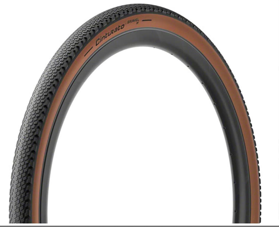

I would like for your considerations the Pirelli Cinturato H - it appears a lot of the fast midwest guys run these tires as all year tires.
They are another example of BRR not giving them full justice and a lot of users. Brown sidewalls just must be faster???
Good suggestion. Wonder if it is as supple as the RH.
One of the few > 45mm
It’s interesting that they have a 50mm tire. But just on paper seems very heavy. Probably not as supple.
I honestly didn’t even know they were offering a tire that size
I’ve ran this tire. It is pretty fast, but not very supple. Not my cup o’ tea.

Have you run the Strava Bianca on gravel? I had them and loved how they felt and rode but would not agree with good puncture resistance - they’re rather fragile I felt.
How true to size do the larger terreno’s run? I had a the 33 on my ride bike with 21ID and it ballooned to 35.5.
Yes, just riding, not any racing with them. I have about 4k miles between two sets and have not had any punctures mostly road, some light gravel. RH Snoqualmie Pass I had 2-3 punctures in the same mileage. Both tubeless.
