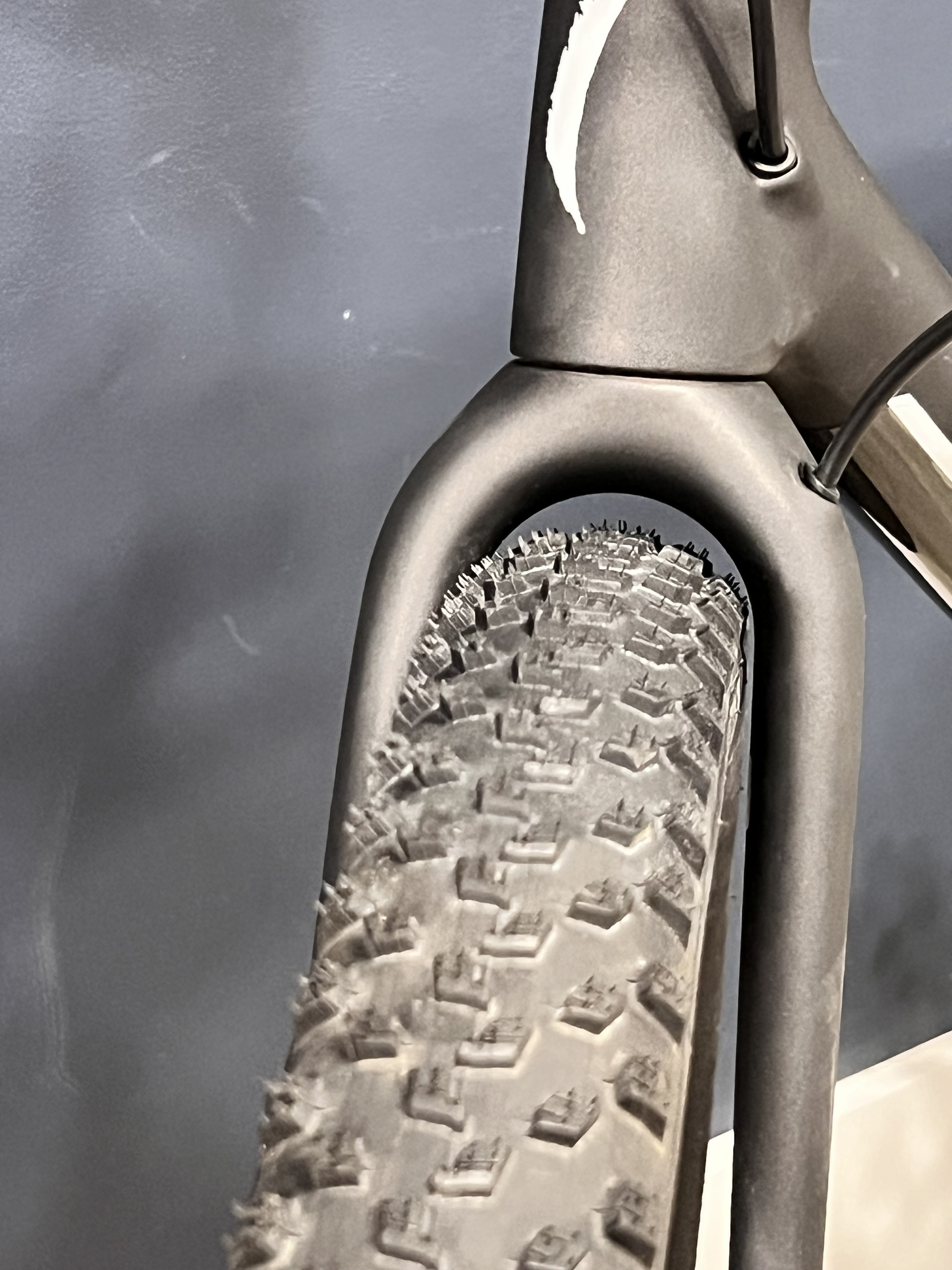

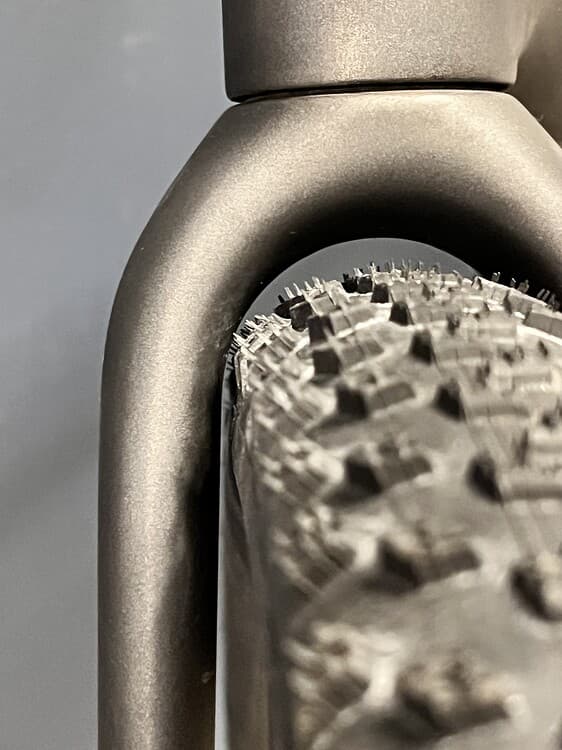

2.2 Fast Traks juuust barely fit in the Crux fork, but the hairs rub the fork side. I’ll trim the side knobs, install some helicopter tape and roll with it and 47mm in the back.

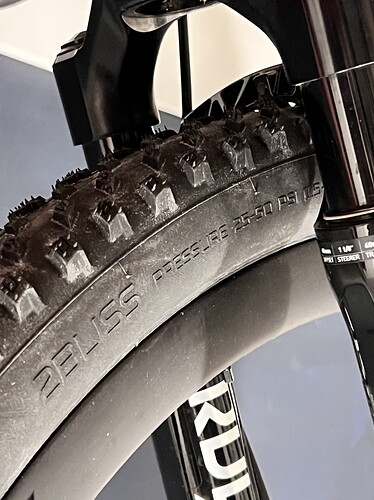

And Rudy has become quite useless for the XC tire hype. 2.2 in it looks quite laughable. Keegan and Tobin ran this fork last year for a few races, but to someone’s point above just because the main dude runs something - that’s not enough to get it viral. You need others to want to do it. And MTB tires - lots of people get behind it, cause it makes sense. Tobin ran an MTB tire before DJ last year, no one noticed and it probably messed up his Stig frame. Now they’re all on 2.2’s.
Your fork is gonna get scarred. Thats too close for comfort

All the pics of these tires with the hairs is giving me big time flashbacks to my early days in Product Development and having to build up bikes for the photo shoots.
We would have to trim all those little hairs off bike tires by hand…we tried everything to get a more efficient way to do it, but the best option was little wire clippers that we found at Radio Shack.
We called it “Nubbing”, as in trimming all the nubs off the tires. Every single hair on every single tire, clipped by hand…and we usually shot dozens of bikes. It took HOURS!!

I was doing that today on my rear tire but, just the left side outer knobs. I also shimmed my wheel by adding two thin washers on the left to just move over the tire more towards the right by maybe a mm. It seemed to do the trick and resolved the very slight rubbing I had yesterday on my left chain stay.
