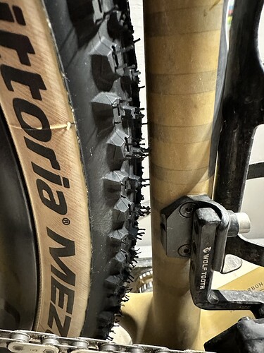

Not sure if a diverge fork is tighter than a crux, but heres a mezcal on a 25 iw rim

Pretty sure the Crux uses a different fork than the Diverge….but that is TIGHT!

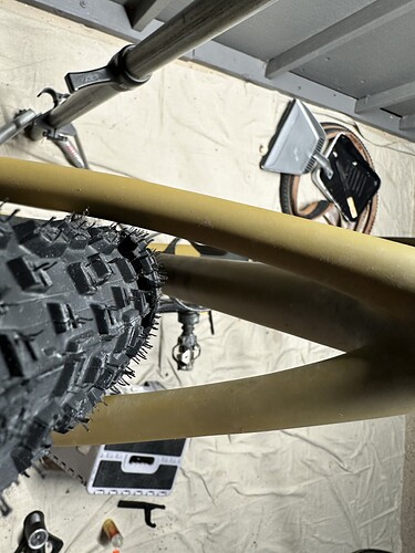

I ordered a 2.2 Fast Trak and 2.25 Severe for the front to see if/how they fit.
Will keep rear on 47mm Rhombus (to pair with Fast Trak) and also ordered a 50mm Ravager (to go with Severe) for the wet muddy winter season.

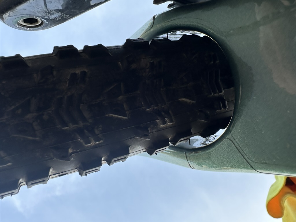

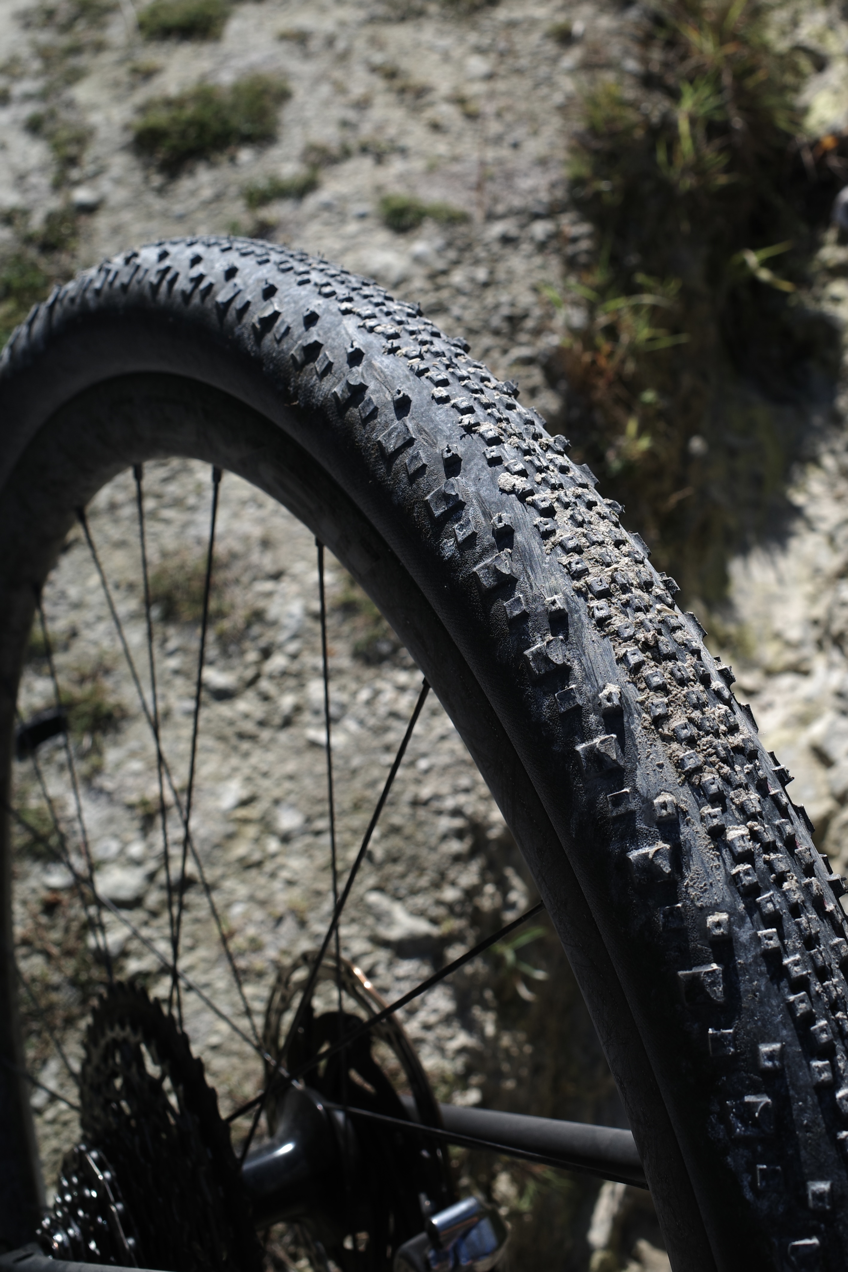

2.1 TB on Crux fork
Rim width?
These are on Terra CLX 25mm

I used 2.1 TB in the back yep. But it rubs slightly so I cut down the outside knobs. The setup worked great for my summer dry rocky terrain here. But it would be too close for mud, so will switch to 47mm in the back for the winter.

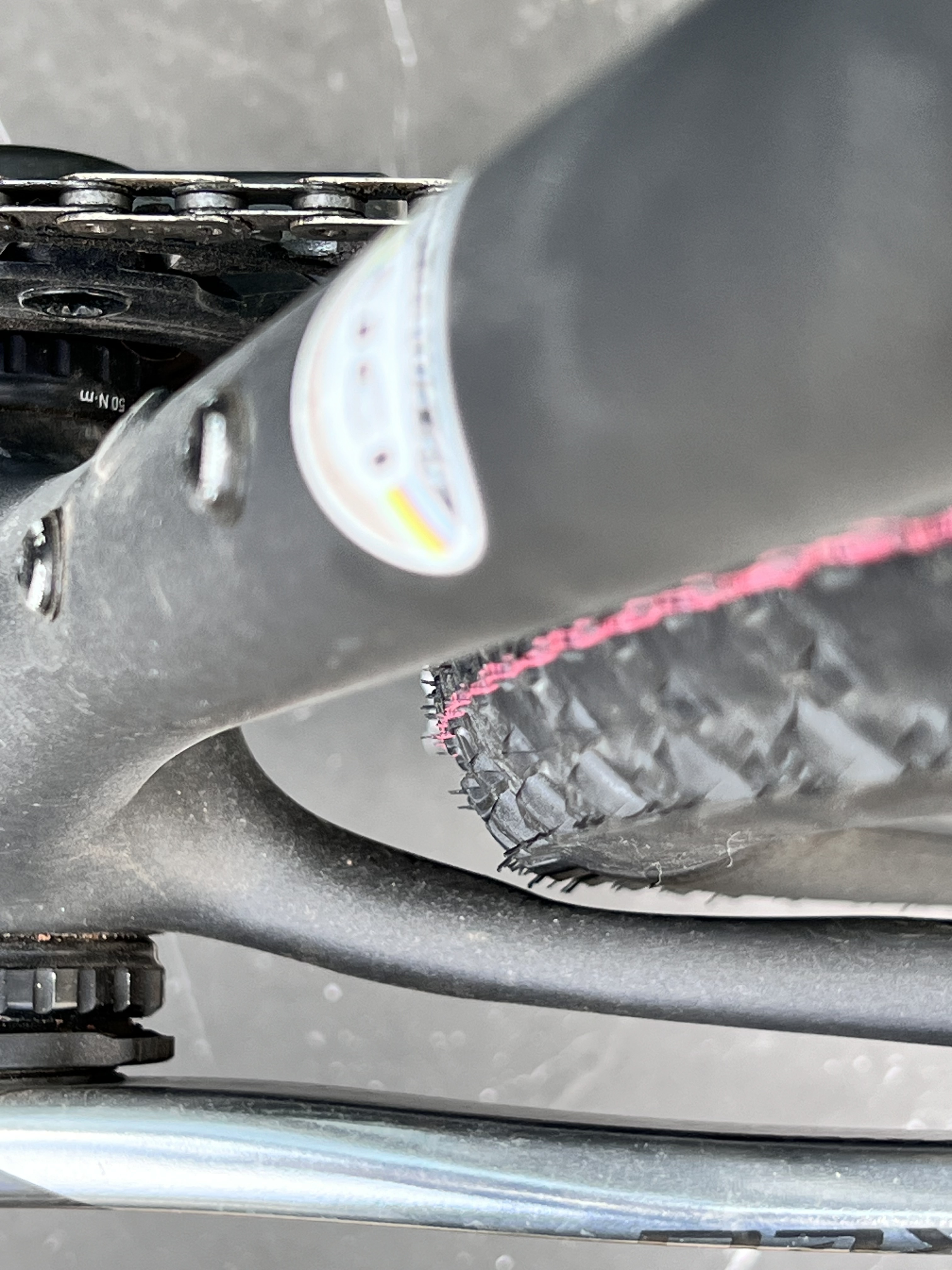

2.1 Mezcals on the rear of my crux. Tire hairs are rubbing the chainstays and just tickling the seat tube.
Definitely tight…but doable in the right conditions. Thanks for posting the pics.

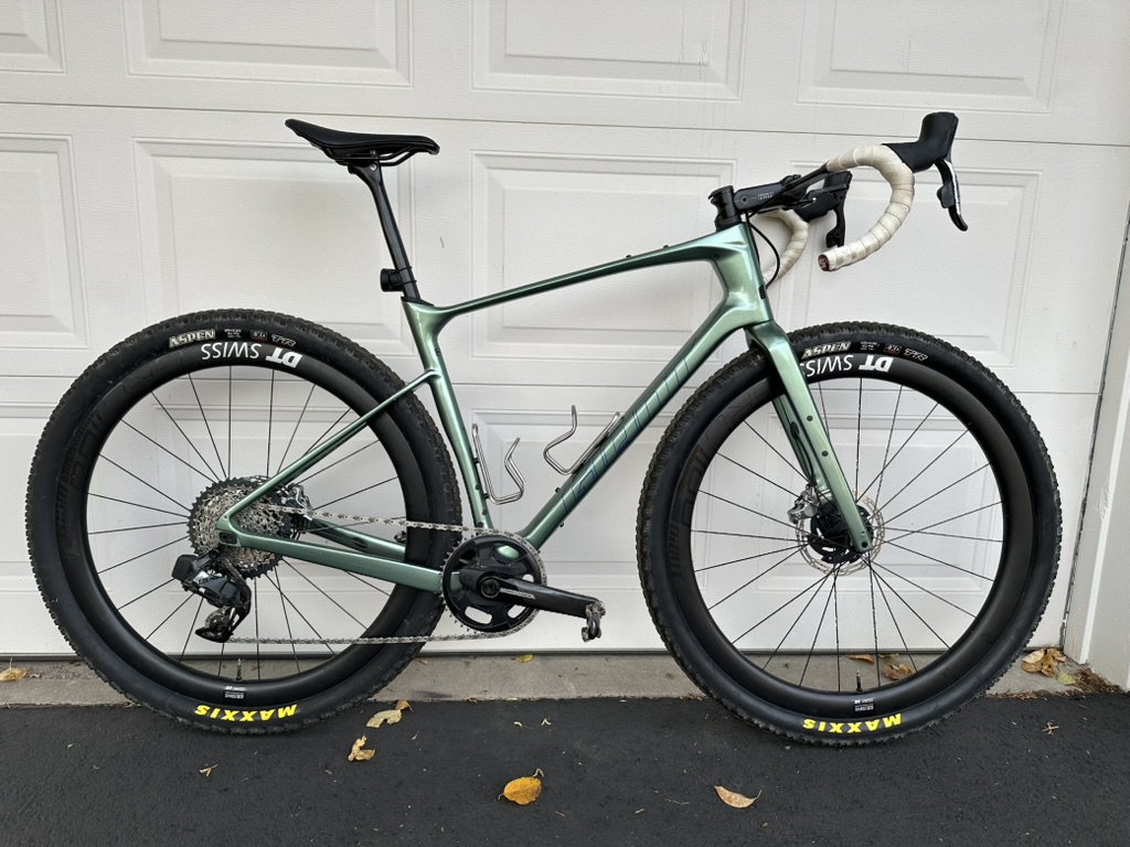

Just for S&G’s I grabbed a pair of 2.25 Aspens that were in the garage and tried them on my Revolt(back tire first). It is tight, but there is no rubbing when either on the workstand spinning or when I rode around a bit. Going to see how it rides tomorrow, but a 2.1 on this bike would very easily fit. Wheels have internal rim width of 24.
Because it is so tight - and I was having second thoughts on using the rear do to potential damage, I just had the idea to get some paint protection film and I will install that on the areas that I want to protect back there.
