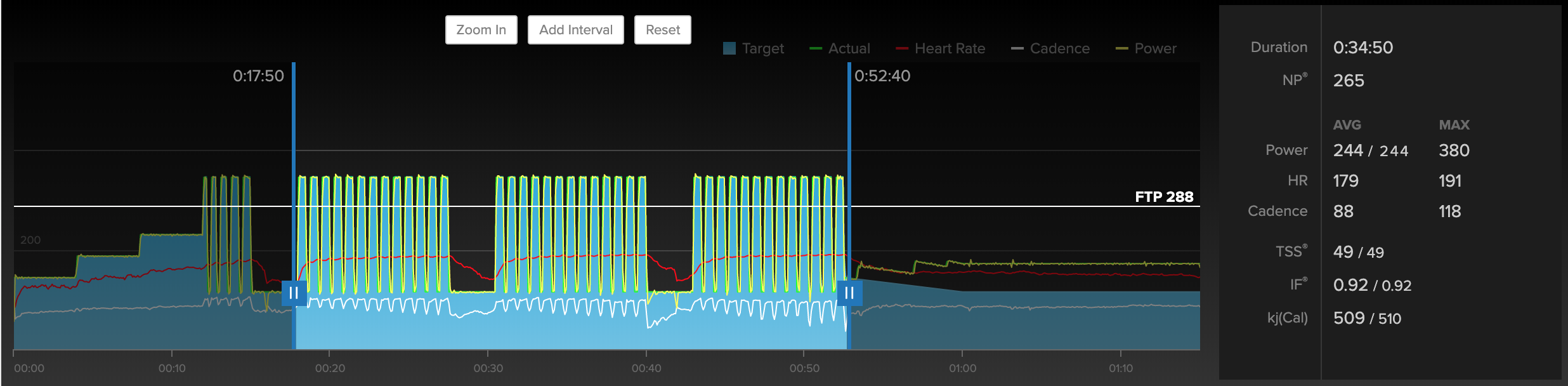

@Captain_Doughnutman Sorry to tag you all the time but today I did Brasted 30/15s in TR-style. So did it with full ERG-mode on and check out the HR. 179 avg. and my max is 198 so just about 90,5% average HR. Did not go into anaerobic >192bpm so I consider it a success. Much easier workout in my mind if I compare to those 3 minute intervals at the same percentage, i.e. 120%. This is my first week coming from 1 week off the bike so I guess that there’s room for improvement.
Picture perfect! :+1::muscle:
You can tell this was a good workout for you by your cadence. The range gets wider from the start to finish of each block as well as getting more ragged during the last block, meaning you were putting in decent effort & getting fatigued — this is how VO2 workouts should be.
(Compare your cadence from the first 5 primer/warm-up intervals - super tight - to your cadence in the last block - survival!)
It’s definitely worth keeping track of your workouts and analysing them for nothing else but to discover your strengths and not-yet-strengths.
