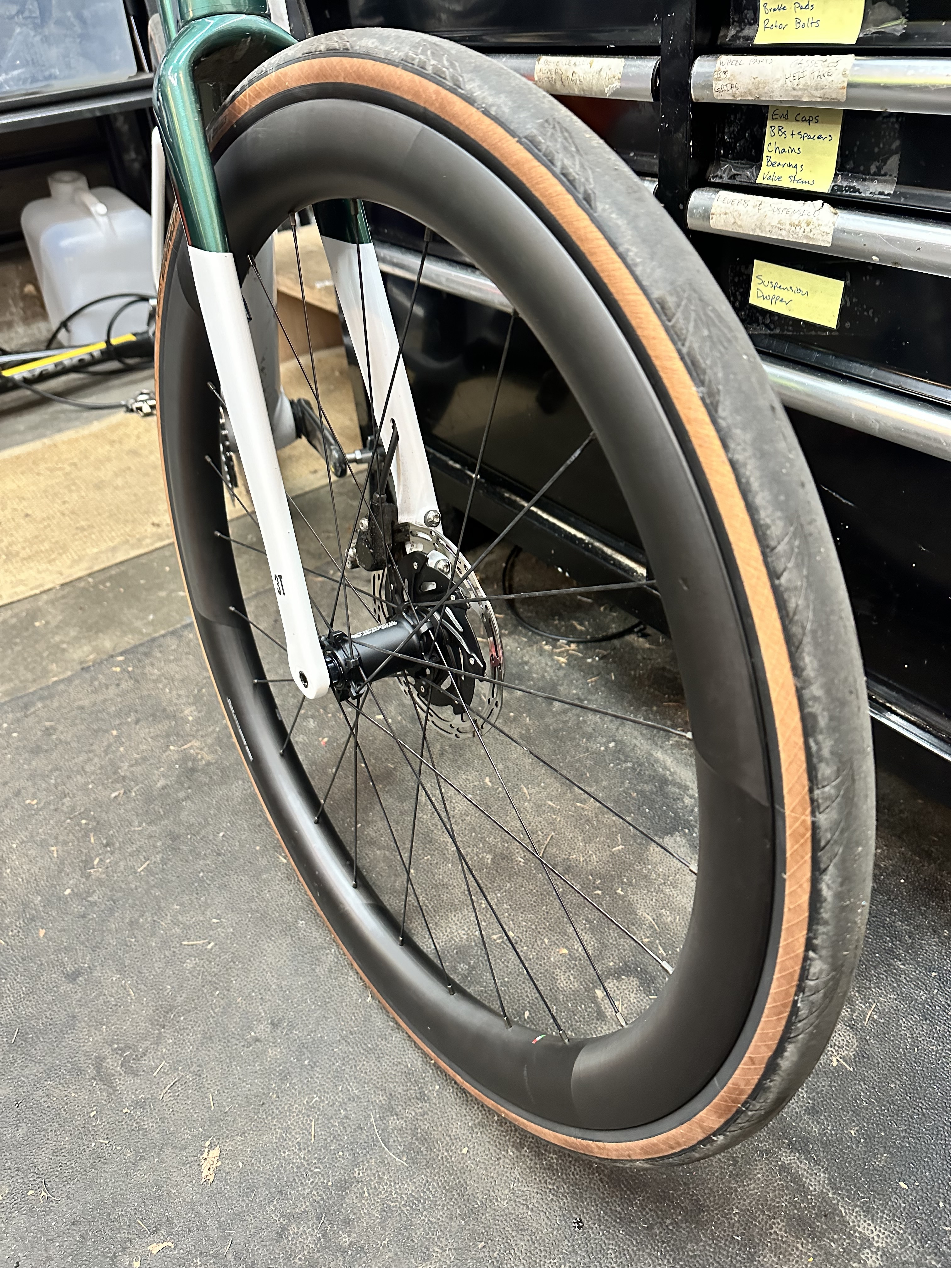

On my NXT45AGX with a 700x35 Pirelli Cinturatio H tire it measures out to be 39mm at the most bulbus area of the tire. It looks like a perfect match to me.

I’ve been running the Josh Poertner Special setup on the road lately: 3T Discus 44/40 wheels with 32mm GP5000s. This is a 30mm ID hooked rim, 40mm external, very round cross section. This violates ETRTO of course, but Josh has said he’s tested them extensively and they exceed all blowoff requirements.
The result, as Josh said, is a ~37mm wide tire with great aero characteristics. I’d guess they’re a bit less aero at 0 yaw than a narrow rim, but in real world conditions I think they perform great. Of course you need a frame that can take the width; I run em on a 3T Exploro or Orbea Terra, both gravel frames. Very comfy and fast on poor pavement and light gravel. Definitely love these.
