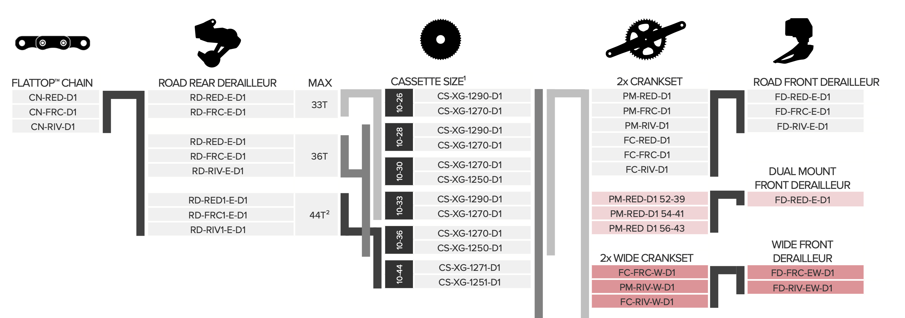

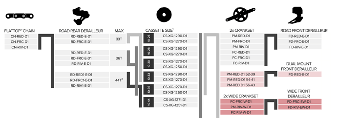

I ordered the group below
I’m assuming that is normal (not wide) front derailleur. AXS crank (Rival, Force, or Red) in 46/33T, 48/35T. And 50/37T is available in Red
I managed to get the last asx red crank but it is 170mm unlike my ultegra which is 172.5mm. Looking around a bit more for 100 euro less I found a 172.5 force crank. Would the red work or should I get the 172.5 force crank.
So you didn’t get a complete groupset?
170 will likely work fine but no one here will know how that fits you specifically. The Force 172.5 will be the same as your current setup and also cheaper. That’s likely the safer bet.
You’ll also need a cassette and bottom bracket. The bottom bracket will be specific to your frame.
I’m not clear but it looks like you may need a chain as well.
