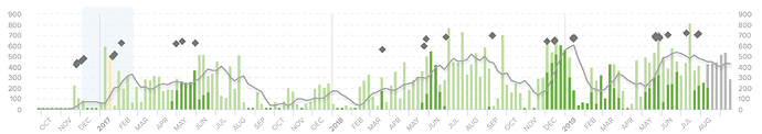

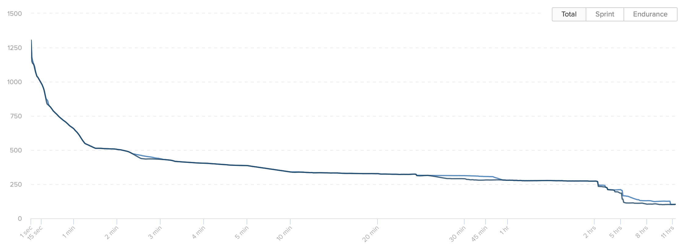

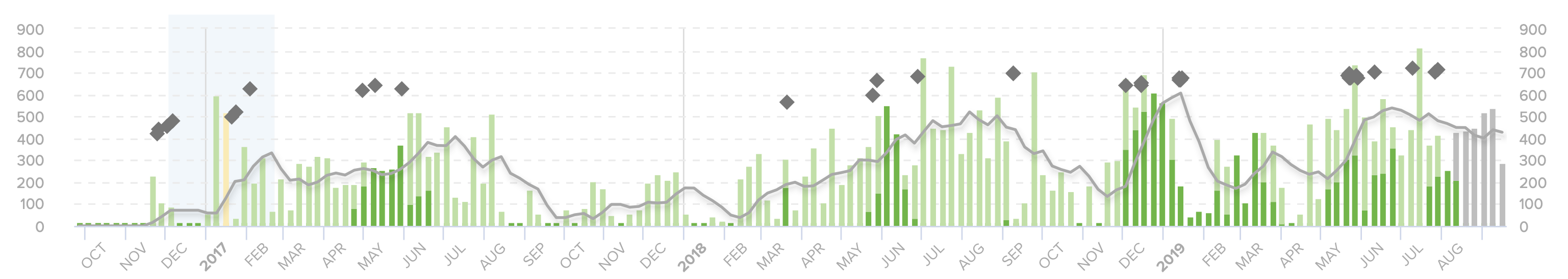

After having followed this thread for quite a while and having reached > 5 watts per kg @ threshold I thought I would give some insight into my process and thoughts.
  1. Process:
  • I have been cycling for a few years now, however have only followed a structured training since winter 2018 with a PM. I also worked with a coach in 2018 until September but have moved to trainerroad since then
  • In May 2018, I tested 20mins @ 320 in and did almost exactly 305 over 1 hour a few days later, so the 95% of 20 min applies quite well to me for the threshold approximation. Weight was 67kg
  • Later in the season did approx 320 for an hour. However, keep in mind these tests were done outdoors and on a climb. My power on the trainer is approx 20 watts lower
  • 2018/2019 winter I did traditional base mid volume with a lot of skitouring on weekends, followed by sustained power build high volume and century specialty high volume. Mid May 20 min test @ 335 watts, weighing 65kg, hence slightly under 5 watts / kg
  • Sunday did my last 20 min test @ 345 watts, weighing 63.5kg. Applying 95% of 345 leaves me at approx. 5.15 watts / kg.
  1. Learnings
  • You have to love riding your bike A LOT and put in the volume. I ride 6 days per week and would ride even more if work would permit.
  • Stay healthy. Thankfully, I have stayed healthy most of the season and was able to train throughought the year
  • Best consistent: ride your bike at least 3 times per week (ideally in a structured manager), even in the off-season, and do other aerobic exercise if you are on travels or similar.
  • Have your weight under control: As you can see from my increase in watts I was only able to increase my power from last season by a meager 10 watts over 20 mins, the major gain in watts / kg is from my lower weight. Taller riders are obviously at a disadvantage
  1. Thoughts and learnings
  • You will never the fastest rider out there. Having reached > 5 watts /kg I am still not the fastest rider: I get by but kicked up climbs and blew up on the last climb of my A-race - it just goes faster, hahaha
  • The urge to go faster never ends: I still want to improve and feel there is potential, however, it just gets more difficult
  • The doubting never stops: As I reaved > 5 watts / kg also due to decrease in weight (63.5kg @ 181 cm is the skinniest I want to get) I question myself if this is sustainable and whether I will be able to reach these power numbers again next season
  • Question where to go from here: How do I continue improving. I feel I have a quite strong base and feel comfortable at riding extended periods at sweet spot or threshold. However, my V02 max efforts and sprint efforts really suck. I would like to try to continue growing my threshold by work on supra threshold power. I am open for any recommendations. Plan would be to do sweet spot base high volume with a long mountainbike or trainer ride on weekend. Build I have no clue yet, but most likely I will follow general build, as it has a nice mix of all kinds of efforts.
I hope my experience is valuable for someone out there!
Keep on riding,
elvis
