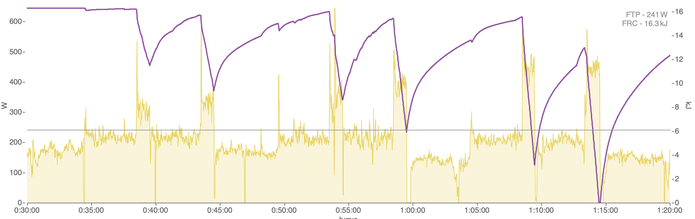

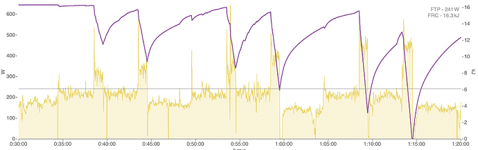

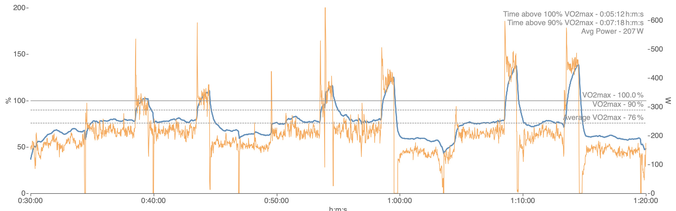

For example last week was doing some 1-minute efforts by feel, and ignoring power meter and HR. Here are the final 2 efforts (out of 6), with 4-min recovery between efforts:
(2nd interval stutter - lost my nerve to go full gas on a hard left turn when the timer said go just a few seconds too early)
and after the ride looking at the data it took:
  • a hard start effort at 240% FTP (600W)
  • settling into 180% FTP (450W)
to reach that state of maximum oxygen uptake. Power on both was nearly the same. Again was doing those by feel (earlier efforts much lower power), and after the ride noted that HR took ~20-seconds to jump from 84% HRmax to above 90%. Was totally “gassed” and needed close to a minute for breathing to recover.
Always fun to look at modeled vo2max in WKO5:
and dFRC:
Those last two were at 93% of PDC for 1-min, which seems somewhat inline with earlier WKO4 webinars on intervals. Certainly felt like I hit max oxygen uptake on the last 4 of 6, but intervals 3 and 4 took like 40-sec before I was breathing hard (500W start and 385W plateau).
I’m an older diesel with ok-ish max 5-sec power (1000-1200W) and ~250W ftp, was a little surprised by how many W and % over FTP it took to quickly push myself to max oxygen uptake on this experiment somewhat along the lines of anaerobic capacity style intervals (e.g. 6x1-min with 4-min RBI).
