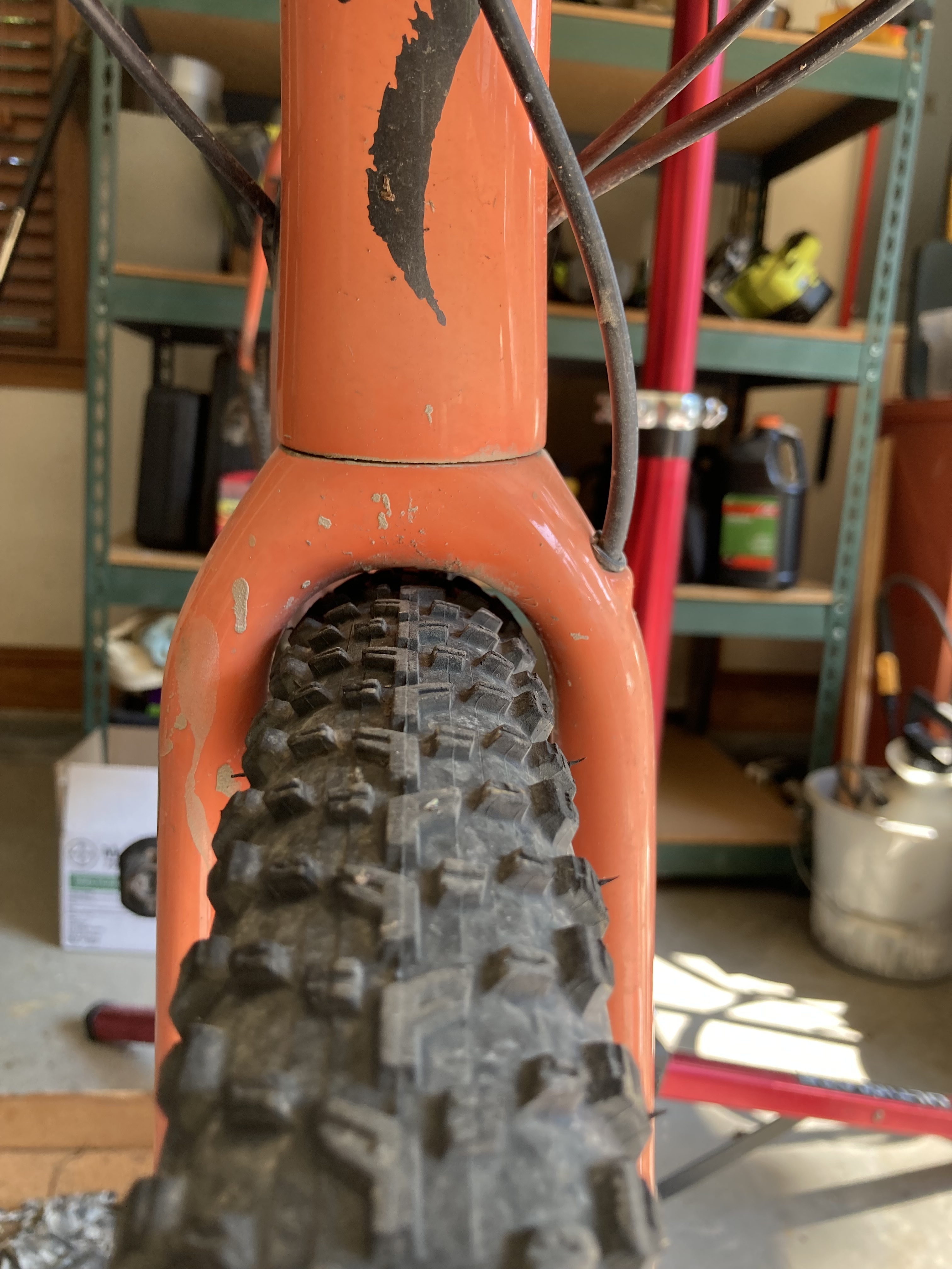

2.1 mezcal on 21 rim, on diverge, not sure if the crux has more clearance. Pretty tight.
Honest question. I’m generally conservative on tire clearance because I’m larger and prone to bouts of exuberance and riding bikes harder than intended. Does anyone run tires with clearance like this?
That looks too tight!
I wouldn’t run a tire that tight on my TT bike :rofl:
I just see comments like “ it doesn’t rub the frame so we’re good”, or manufacturer says 42s but I’ve got some 47s and stuff like that, and those don’t make sense to me
I raced the traka with a 2.2in mtb tyre ~2mm on each side of the tyre to the sides of the fork… It was a bad idea as it rubbed through a lot of the paint with the small bits of mud we had.
saying that, it definitely enabled me to be very speedy on the descents and rough washboard.
Was it worth it? Yes, for this one race and in a pinch. would I do it again? no. The best tyre is the widest tyre you can run with enough clearance for what you do, how much clearance you need is up to you. My frame is supposedly 45mm tyre clearance with 6mm clearance each side, however I run a 2.1 thunder burt up front and a 50mm G one overland on the rear. both come out at around 48-49mm width when measured. and the frame has plenty clearance (3-4mm) each side.
I did not even try, too tight. Maybe a pro would since they can get free frames
