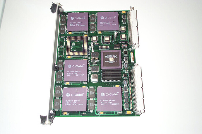

(Nostalgia time - I was working on this at C-Cube Microsystems, in the mid-late 90s, and at the time C-Cube had the ‘world leading’ MPEG1 encoding chipset, which took 7-8 chips to do real-time encoding of 720x480 video. Here’s a picture of an encoder board, which was fairly hard to find. Things have come an incredibly long way since then. Also, several of the high level technical people from C-Cube went on to form Ambarella, although that was several years after I left.)
Thanks, that’s interesting. Will be interesting to see if dropping to 720p could actually improve things then… I guess it may come down to whether the uncompressed data actually has the required info, combined with the bitrate chosen for the 720p files.
(I actually work with images as my day job, but they’re either uncompressed or lossless, so this is not my area…)
It’s hard to know what is better here, especially as license plates have fine detail that could benefit from higher resolution. I’m not sure if we know if the bitrate is the same between 720 and 1080. There can also be HW limitations, such as how many motion compensation vectors could be generated per frame, which would affect image quality somewhat independently of bitrate.
If bitrate is truly the primary limiting factor for quality, it could be that for many scenes 720 could ‘look better’.
