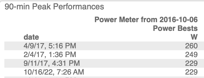

For example in TrainingPeaks this is listed as 3rd highest 90-minute power:
and then clicking to view:
Its not 90 minutes, it is about 109 minutes. Because of auto-pause.

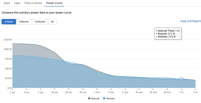

And for that activity I posted earlier on Garmin Connect:
but Garmin only lets me show 1 hour or 2 hour power on that curve.
