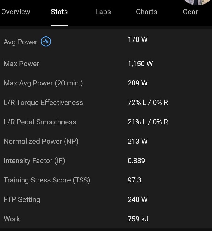

Buddy of mine got a new power max today according to his head unit, and also on garmin connect. 1100 something.

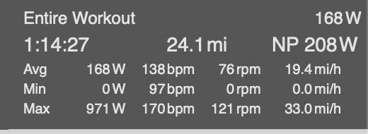

Strava shows 900 something, so I asked him to send me the .fit file.
I looked at sensor data, and the 900 something is all that I am seeing in the .fit file sensor data, but Garmin Connect shows 1100 something. He sent me a screenshot of his GC page. And it displayed it on the head unit.

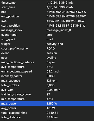

Good idea. Here’s what FitFileExplorer shows. 1150.
Question - is that in the summary message (FitFileViewer) or in an individual data message? Maybe one-off bug when the summary was written.

Summary.

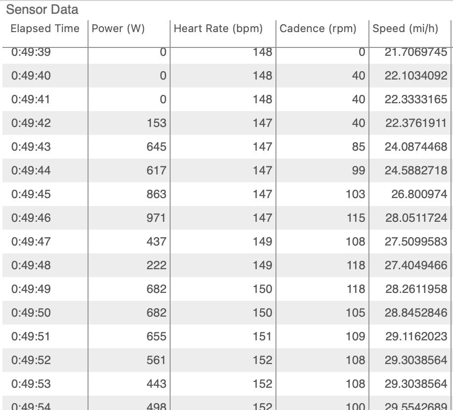

When I examined the individual data records, this is the max value that I was able to find. No 4-digit power number exists.

Are all the data records a second apart or are there gaps where smart recording has trimmed some?
second by second there is a record
yes, thats different.
Open the file in FitFileViewer.com and then open the Session message and scroll until you see Max power:
What do you see?
Same as in the fitfileviewer application. 1150. But there is no 1150 in the second to send list of records.
Apparently the bike computer made an error when computing the Summary, and then:
  • Garmin Connect appears to be showing the incorrect value from the Summary
  • WKO, Strava, and others are finding a max from all of the 1-sec power records
The power meter talks to Garmin more than once a second. Therefore possibility your Edge saw the 1150W value but it didn’t make it into the lower resolution second by second fit file.
