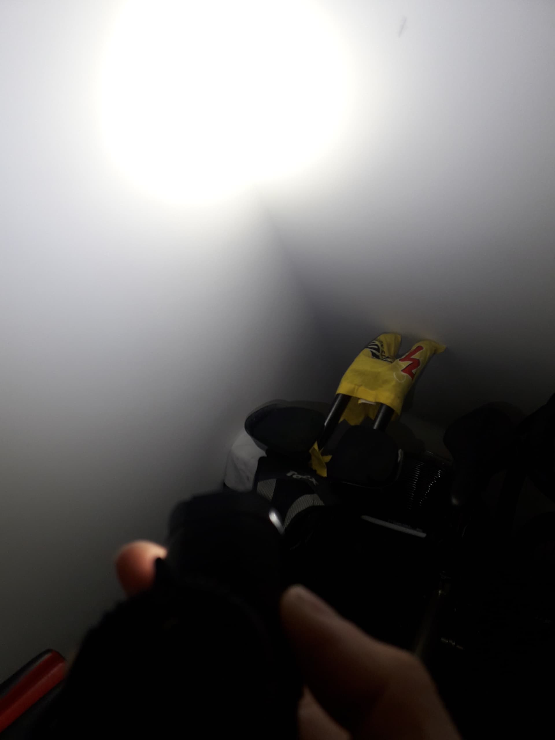

I use the Varia front light too but I can’t recall any yellowing or strips. Ive just took a pick and I cant see any.
Thanks for the reply. Just in case it’s not clear, the stripes are from the Detour. I’m hoping some Detour owners will reply with whether they get them or not.

Yeah, I rarely use my Varia front light because of the yellow tint. Much prefer a whiter light for riding.
That would bother me for sure. I don’t see stripes in this post Reddit - Dive into anything
I’d contact outbound for sure
Thanks. Since so many people were enthusiastic about them, I was expecting a quick flurry of “yes, that’s normal” or “no, it’s not” posts before I went to the manufacturer, but I guess I’ll just write them.
Not sure if this helps but I have their hangover helmet light and it doesn’t have those stripes
I don’t see that on mine. Maybe it’s some rolling change in the optics?
Helpful! Thanks.
Just to close this out, I got a response from Outbound that “these are indeed normal, nothing wrong with the light, it’s something we did to the front lens (the vertical ribbing) that was there so that we could better blend the main spot of the beam down the road, and we decided after getting customer feedback that making the coverage down road more even and how we wanted it was worth a bit of nearfield uniformity.” They also mentioned that when they update the light they’ll be “changing the entire optical system”. I appreciate their quick response and how they immediately processed my return. Seems like a great company. Just not the right light for me at this time.

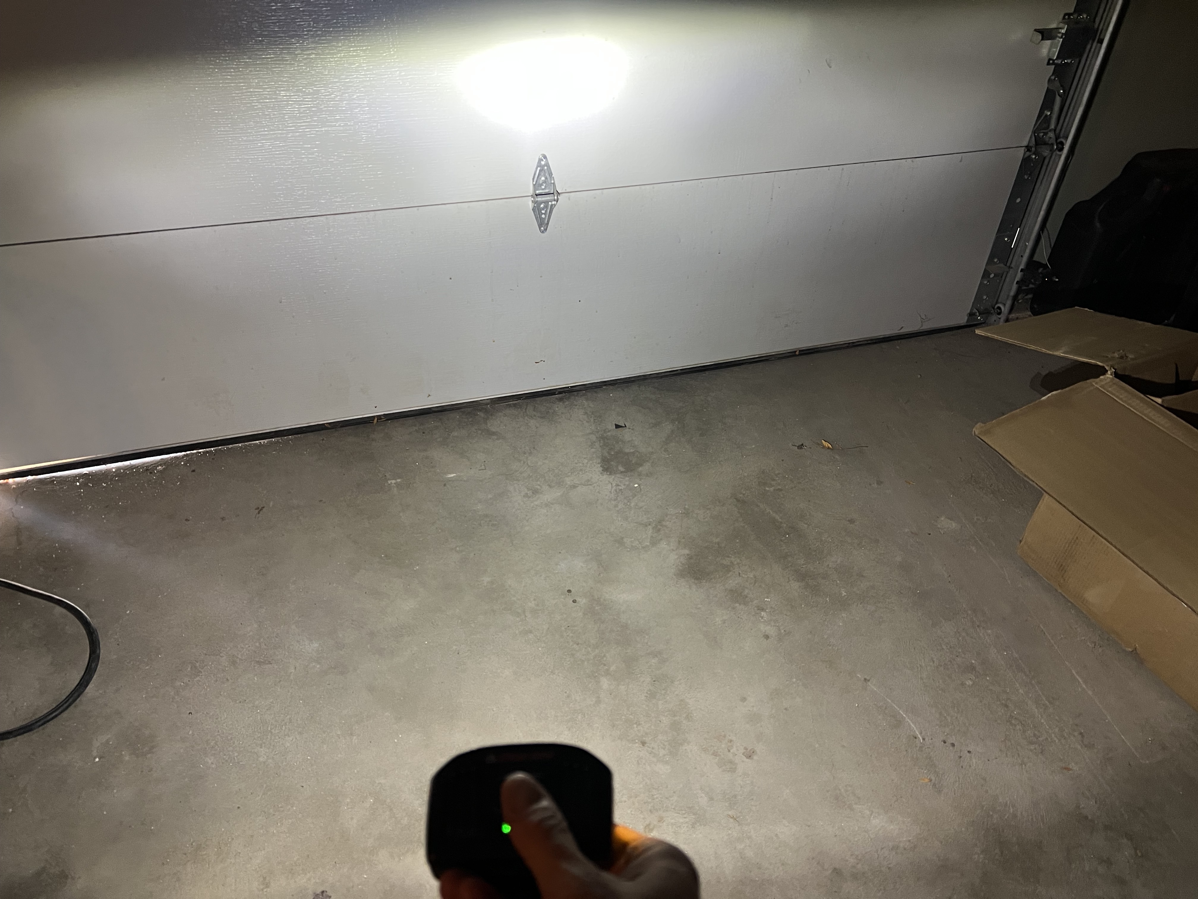

I recently bought an outbound detour, and planned to make it my main light (with USB powerbanks) for through-the-night, long Audax events.
Sadly after getting it and playing with it for a few days it’s just not nearly as bright as I was anticipating, and I can’t use it for night riding at any decent speed.
I don’t quite understand how it’s got such glowing reviews online, as regardless of any benefits of beam pattern etc, it just doesn’t throw enough light forward to see road hazards.
My old lights I was hoping to replace are Moon Meteor Storm Pro. Similar total lumens on paper, but much brighter in use, even on medium. There’s no cutoff, I do not care at this point.
