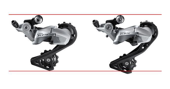

It is not listed, but could be either the Short or Medium cage versions:
My guess would be the short, that officially tops out at 30t max. IIRC, you can look on the back side of the RD to find the full model number and learn for sure which you have.
Like @otnemeM said…depends on the derailleur. If it’s an Ultegra short cage derailleur, it’s rated for a 11-30 but would likely handle 11-32 fine. If it’s the medium cage, it’ll do 11-34 or a Sram 11-36 no problem.
Found a thread at weight weenies that might help identify the derailleur.
comparisson
I think you may be able to employ the Wolf Tooth Road Link DM even if you have the short cage.
Thank you @mcneese.chad this is great now I have a better understanding of the issue. It seems like I have a medium sized (more curved) cage. Glad to see it can fit up to 11x34 on the Shimano web page.
